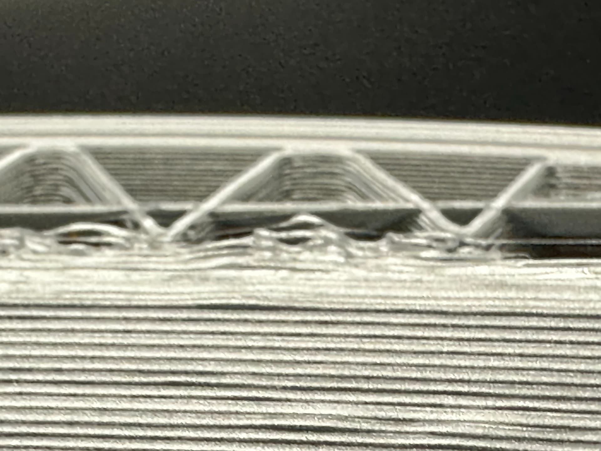

I have a model with a curved shallow slope which exhibits pretty significant lumps / waves / bubbles (not sure how to describe this?). I first noticed the problem printing in Bambu Lab PETG HF; after over 20 test prints tweaking one setting at a time, I tried Bambu Lab Basic PLA and got a nearly identical result. I moved both filaments over to my A1 and they printed the part no problem.
In the attached pictures you can see the bubbles are raised where there is a gap between where the infill touches the walls.

You need to add more cooling. It was too hot so that those spots didn’t solidify quickly enough and hence showed up on the outmost layer.
I usually associate these type of bumps with solid infill edge curling. I find that particularly difficult to tackle though.
For PETG and PETG HF, I usually copy over the cooling values from the Generic PETG profile while slowing way down (<100mm/s for PETG, <120mm/s for PETG HF, all accels to 25% of defaults). It may be overkill on the HF stuff, but overkill is underrated :wink:
In addition, I usually use adaptive layer height to ensure a minimal layer height at shallow angles as that also helps against curling.
And of course, with curling being caused by a hot layer partially supported on a cooled layer cooling itself, I try to keep the build chamber as warm as possible while pulling off the trick of avoiding heat creep.
All of that helps with really thoroughly dried filament but I unfortunately can’t claim that this combination will always lead to success. I have however little experience with further remedies (turn off enforce top layer number (can leave holes) or playing with the number of top layers.

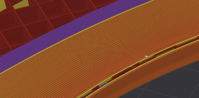

I think it is definitely a problem with solid infill; the problem areas in the pictures from the original post align with the solid infill line type (purple lines in the picture below) shown in Bambu Studio
Solid infill lines are purple
