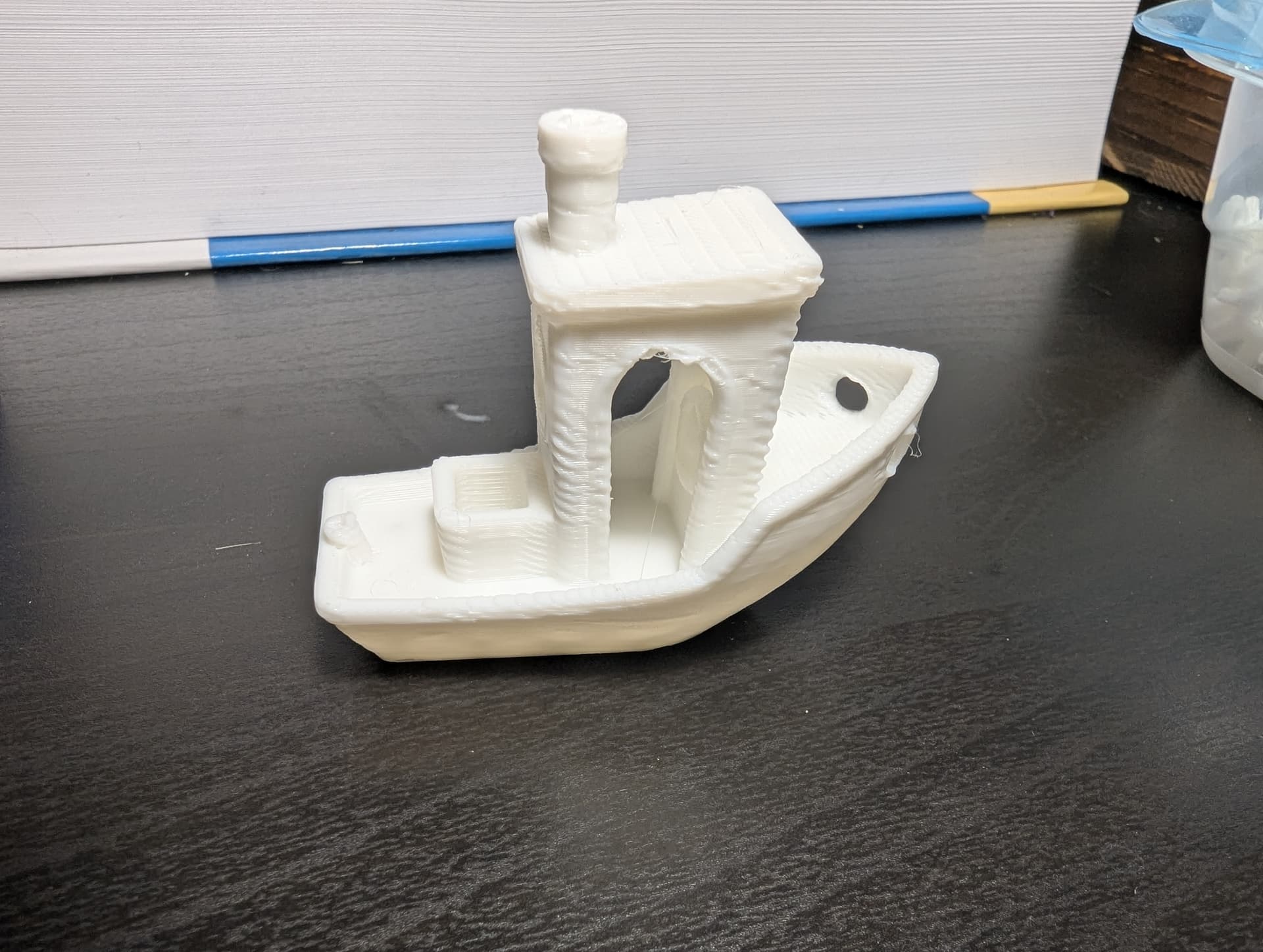

I’ve had my A1 for a little over a month now with no issues. Recently, my 0.4 mm nozzle clogged (unrelated issue) and I replaced it with a Bambu Labs hardened steel 0.4 mm nozzle. Afterward, I re-ran all calibrations on the unit.

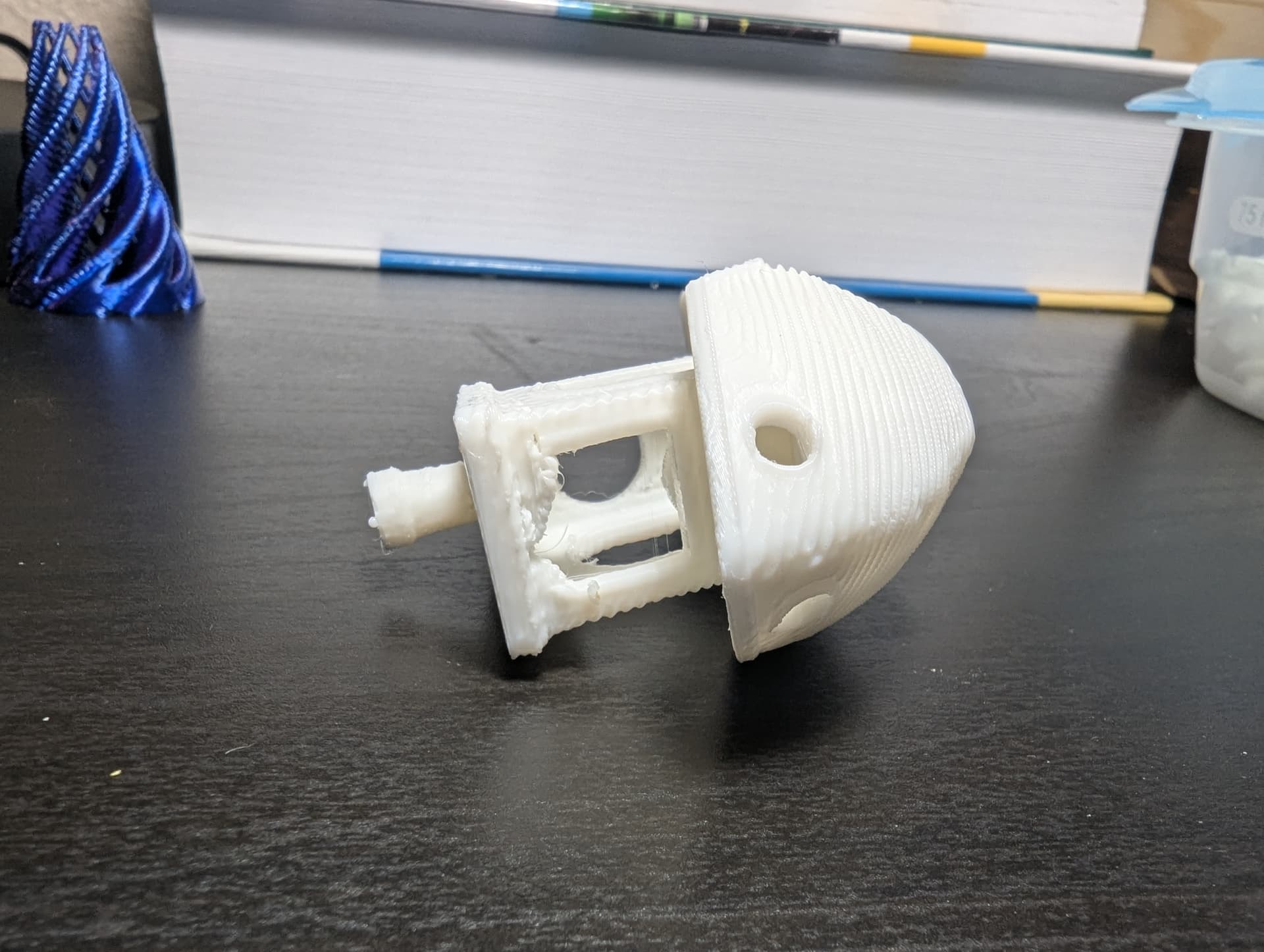

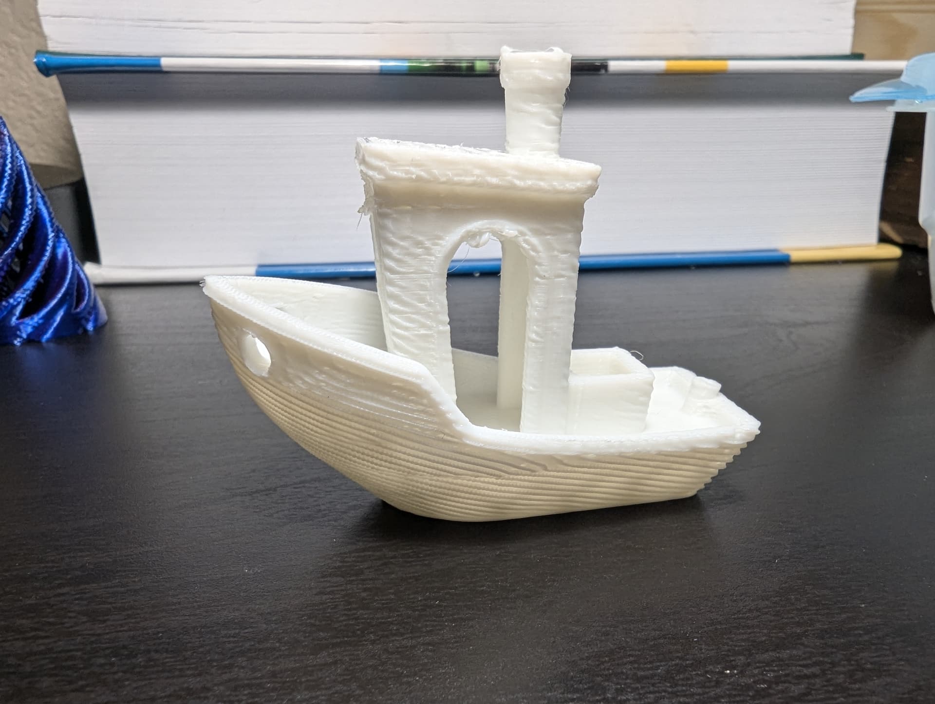

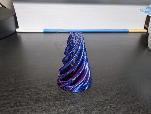

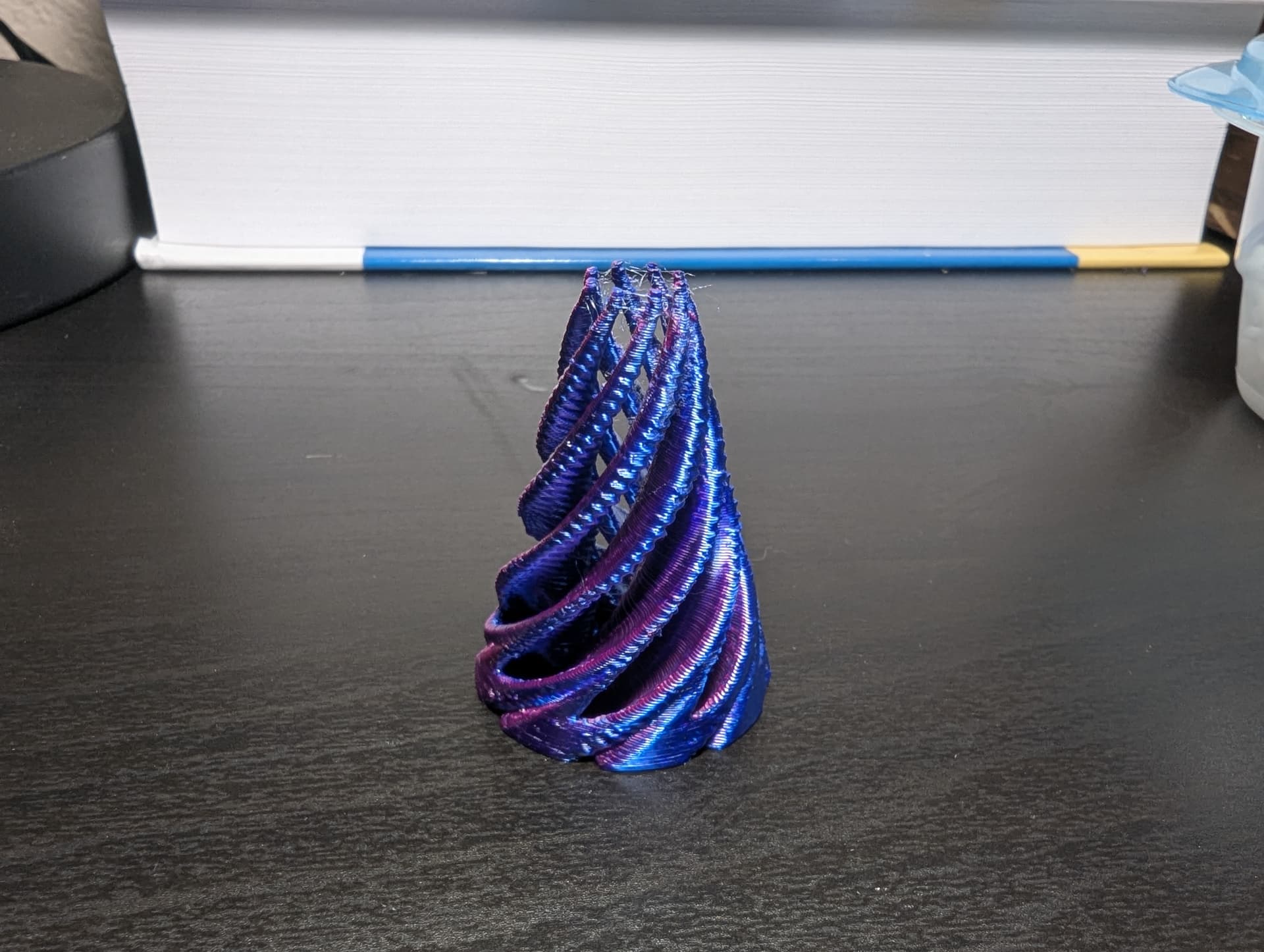

I noticed that after the swap, my prints all have this strange wave-like feature in their outer walls (see Images below), regardless of layer height. I spent the last 2 days attempting to fix the issue. I am familiar with engineering but I’m new to 3D printing, so I’m a bit lost. So far, I’ve attempted the following with the standard Benchy & standard slicer settings, all with no effect:
  1. Uninstalling and reinstalling the hotend assembly, verifying that all bolted connections are solid. The 4 screws on the backside of the heater were a bit loose but not concerningly so. I confirmed that the nozzle was correctly seated and clipped according to documentation. Re-ran calibration.
  2. I found a resource online that mentioned this sort of issue could be related to axis ringing, so I re-tensioned the Y-axis belt. Re-ran calibration.
  3. I ran the PLA filament at different temperatures: 220 +/- 10C. This had only heat-related effects you would expect (extra stringiness at higher temp, less adhesion at lower temp).
  4. I tried other PLA filaments, concerned about moisture. A newly-opened bag of PLA had the same issue, as did another roll that is less than 1 week old.
I have not noticed any other concerning issues.

You said you swapped the nozzle, this would have been my suggestion to fix the problem had you not said that.
However, what happens if you replace the nozzle with the first one, do you still get the same issues?
Did you remember to tell the printer (directly or through Bambu Studio) you have a hardened steel nozzle rather than the stainless steel one?
Thank you so much for responding. I just printed a flawless 0.6 mm nozzle print so I checked the nozzle that I took out of the 0.4 mm box and it is, in fact, 0.8 mm. I just assumed the box was marked correctly. I’ll close this!
