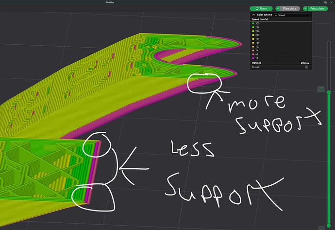

We all know the overhangs are bad while printing fast. if you look at the sliced speeds of the overhangs you see that the location of the speed change is for the most part where the overhang starts so you’ll often get a really bad print quality.
I believe I have a solution to better help with this issue. If there is a setting to allow the distance the speed change occurs from the start of the overhang then I believe it could help with the poor quality of said feature. In the picture attached, you can see the squared overhang has a speed change right at the edge vs the curved overhang. the curved overhang test prints with much higher quality at its highest degree vs the squared edge.
If there was a setting to just change the distance where it started it could help greatly. Thoughts anyone?
