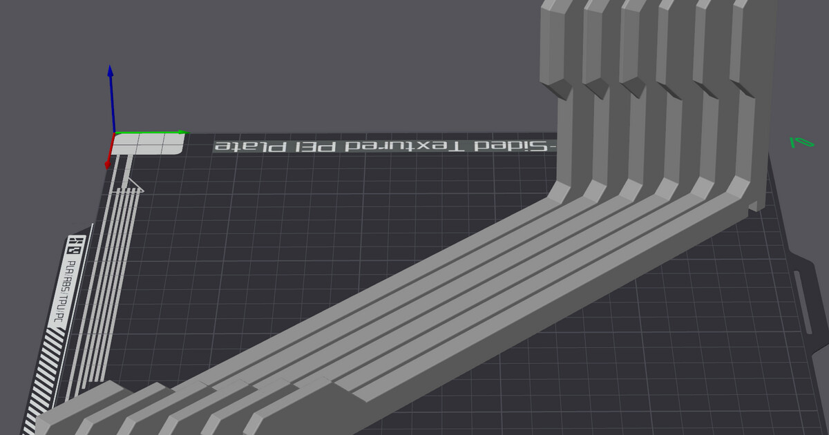

I needed another storage method for my build plates. I ended up finding this 5 plate solution. It printed OK but I was dissatisfied with the weight.
https://www.printables.com/model/529432-bambu-build-platebed-holder-5-slots-trimmed
In the past I used ball bearings and steel disks for weight. However, this time I wanted to try out sand since this particular model had lots of nooks and crannies. So I had the second print pause at 4 layers before it was about to close off the top and with a funnel and cup, I poured sand into the cavity.
Although this came out really great. It has some unintended consequences.
Did you guys know that the part cooling fan is pretty powerful?
:joy:
But I achieved my objective. The sand weighted object was roughly 150% heavier than the non-weighted.
I do not recommend anyone do this at home. I was not able to vacuum or blow all of the sand out of the lead screws and I can hear the grinding. Hopefully, I won’t have to replace them. But lesson learned.

Other than the obvious problem you have experienced, there is another one you may not have considered.
Thermal mass. Many things you may wish to throw inside the model as it prints to add weight or just for fun will add a change to the total thermal mass of the print. Sometimes a little, sometimes a lot.
Imagine (please do NOT do this at home kids) pouring water inside your model during the print. As a good conductor, the water will absorb the heat from the print and cause significant problems whilst printing.
Sand holds its temperature very well (people are now using it in long-term thermal energy storage solutions), and the sand would affect long and warm prints with unknown outcomes.
You are better off adding things in that are not good conductors.
If you wish to sand or even water, make your design capable of having those poured in after the print has been completed and then screw a cap into the hole you used.

I do use sand as a regular weight-increase infill, and I love it. But I adapted the design to fill it after printing, e.g., a small hole in the bottom, using a funnel to fill and a respective plug, thread or not, or whatever fits best to close and seal it.
Depending on the sand origin, moisture is one issue you may or may not have noticed. Sand can absorb moisture, and I made a stupid error in sealing it inside a print. I also like to fill the void volume and avoid the maracas sound.
