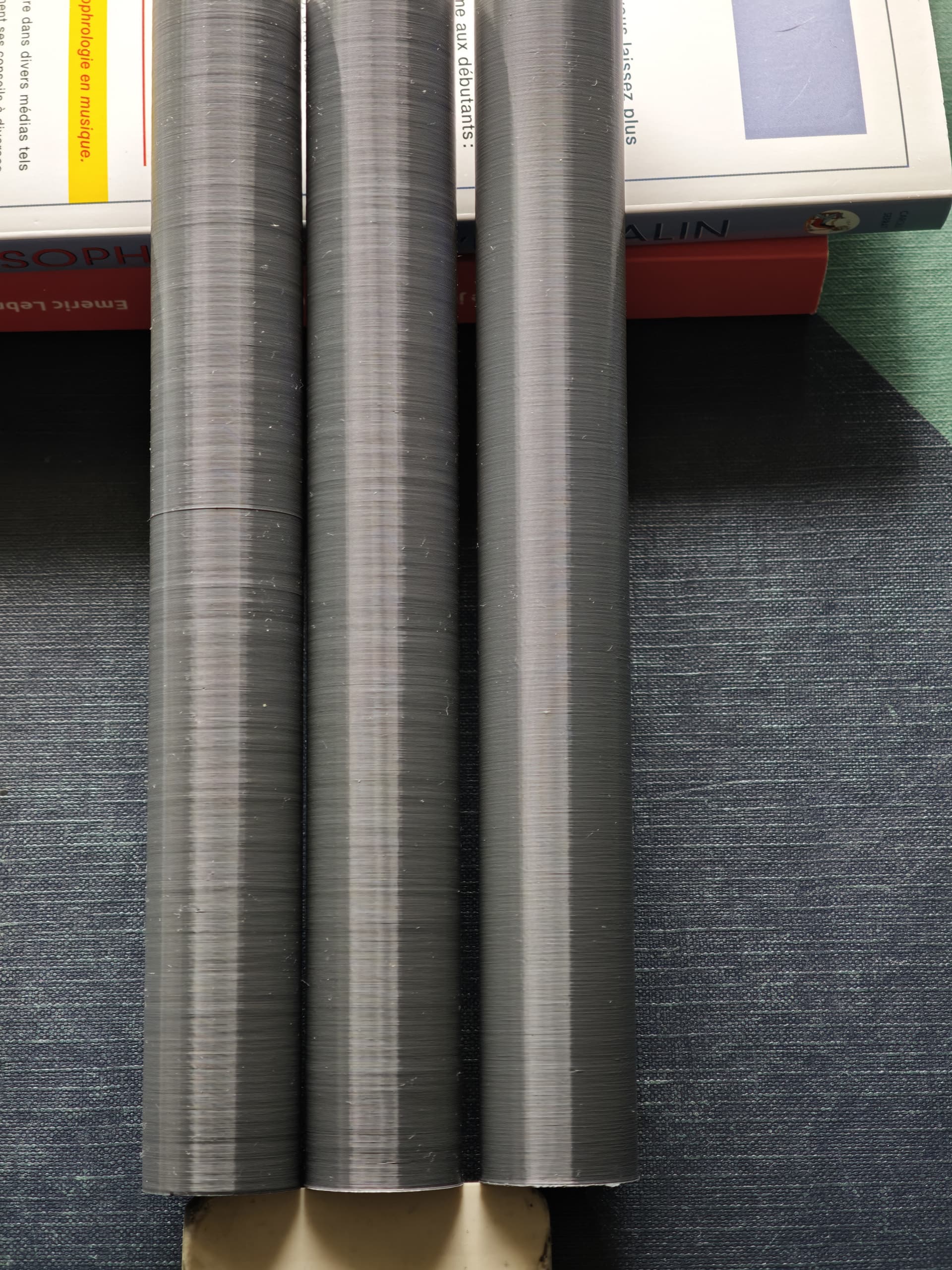

Hi to everyone,
I have a strange issue with my new A1 replacement.
I’m in printing for a while with other printers, never had this kind of issue on a simple model like that.
I have just print an empty cube with 2 different PLA spools. One is a new Bambulab PLA basic purple but same issue.
What tests I have made without success :
  • change filament spool
  • check all axis, lubrification,belts etc…
  • full calibration
  • change seam position
  • change cube position on plate
    The weird pattern always occurs along X axis in one side when the hotend moves to the left as you can see on photos, the opposite side has a very light pattern almost invisible in some case, more visible on gray PLA than on purple.
If someone has an idea of the issue and a fix, it will great.
Thank in advance

I have swapped the toolhead (hotend + extruder + motor + linear bearing) and the artefacts have almost disappear ( very very less visible) so I think it is the linear bearing on x axis. I’m on the old mainboard + the old x rail+ old x motor and the new toolhead.

No it was the bad bearing and oil of bambulab !
Have you found the part that causes this problem?
I’m thinking of buying new parts.
Unfortunately, they don’t sell linear bearing.
Yes it was the X linear bearing and the bad oil of bambulab.

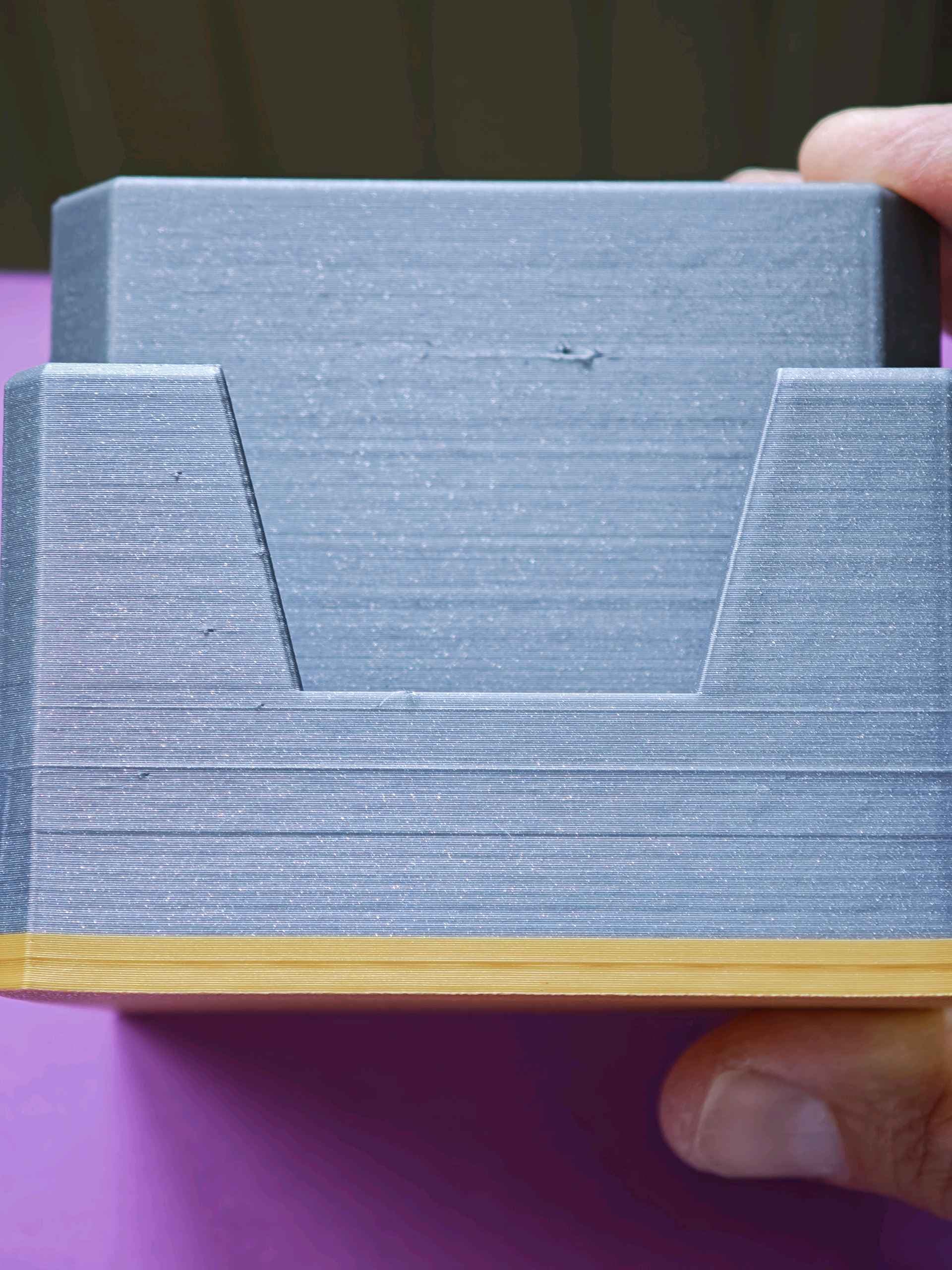

But I have other issues, the print are bad quality even with new bambu spool.
The layers are irregular as you can
see here :
