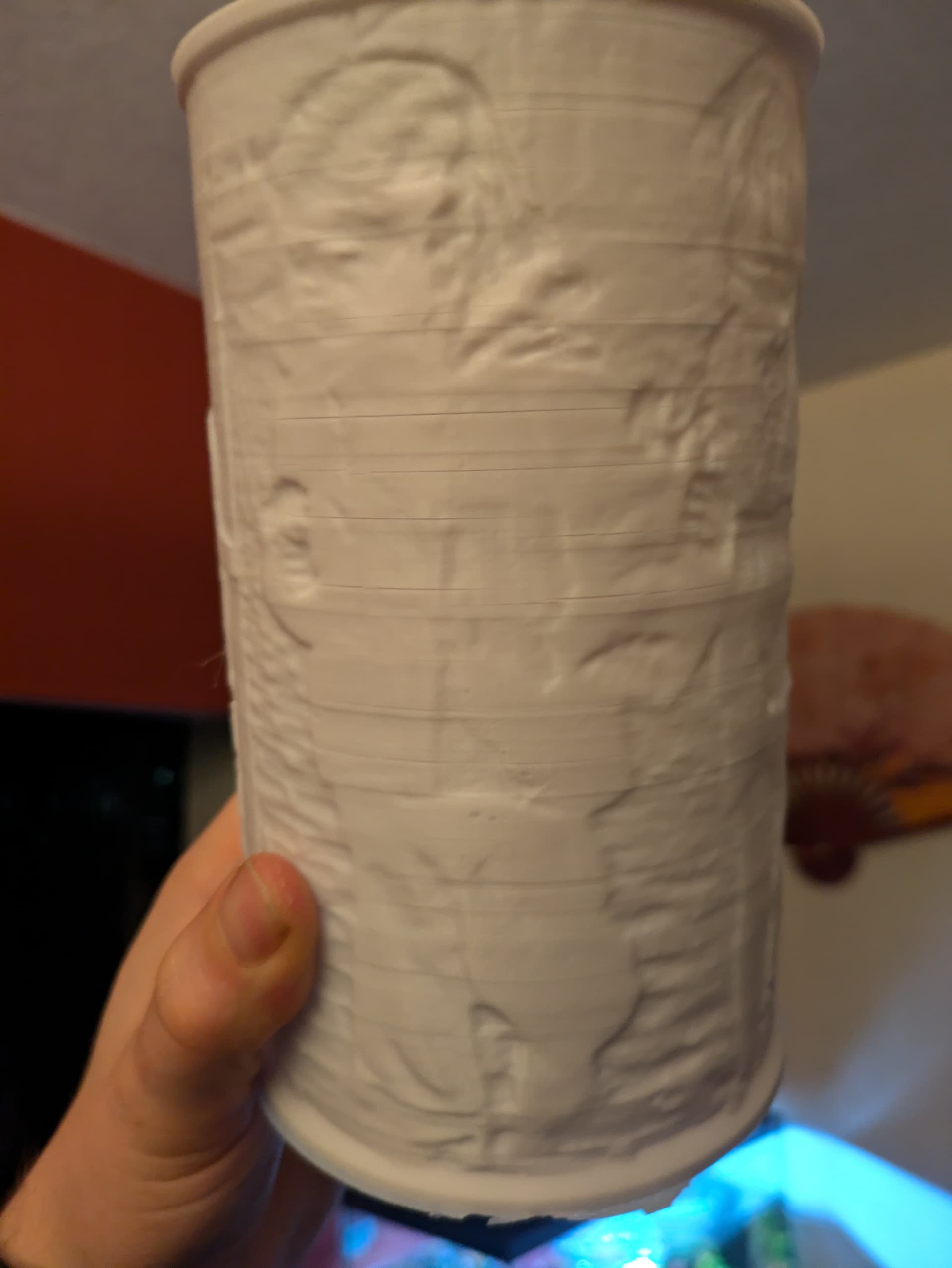

Hello everyone, I really need some help.
I have a P1P for 1,5 years. And it was working perfectly since now. Suddenly surfaces of prints has weird horizontal lines.
I thought it would be hotend and changed it.
I lubricated Z screws.
I did some belt tensioning.
Lastly, I did calibration tests. K factor, flow ratio and everything.
None of it helped. What could be the problem? Any help would be appreciated. Thanks.

Thanks for your reply. I have been using the same 3mf files for some time. I am going to try loading original stl files and print them as you suggested. When I try to print a benchy or a basic cylinder everyting looks perfectly fine. But when I try printing something complex like this vase, bottom and side surfaces are problematic like the ptoho shown.

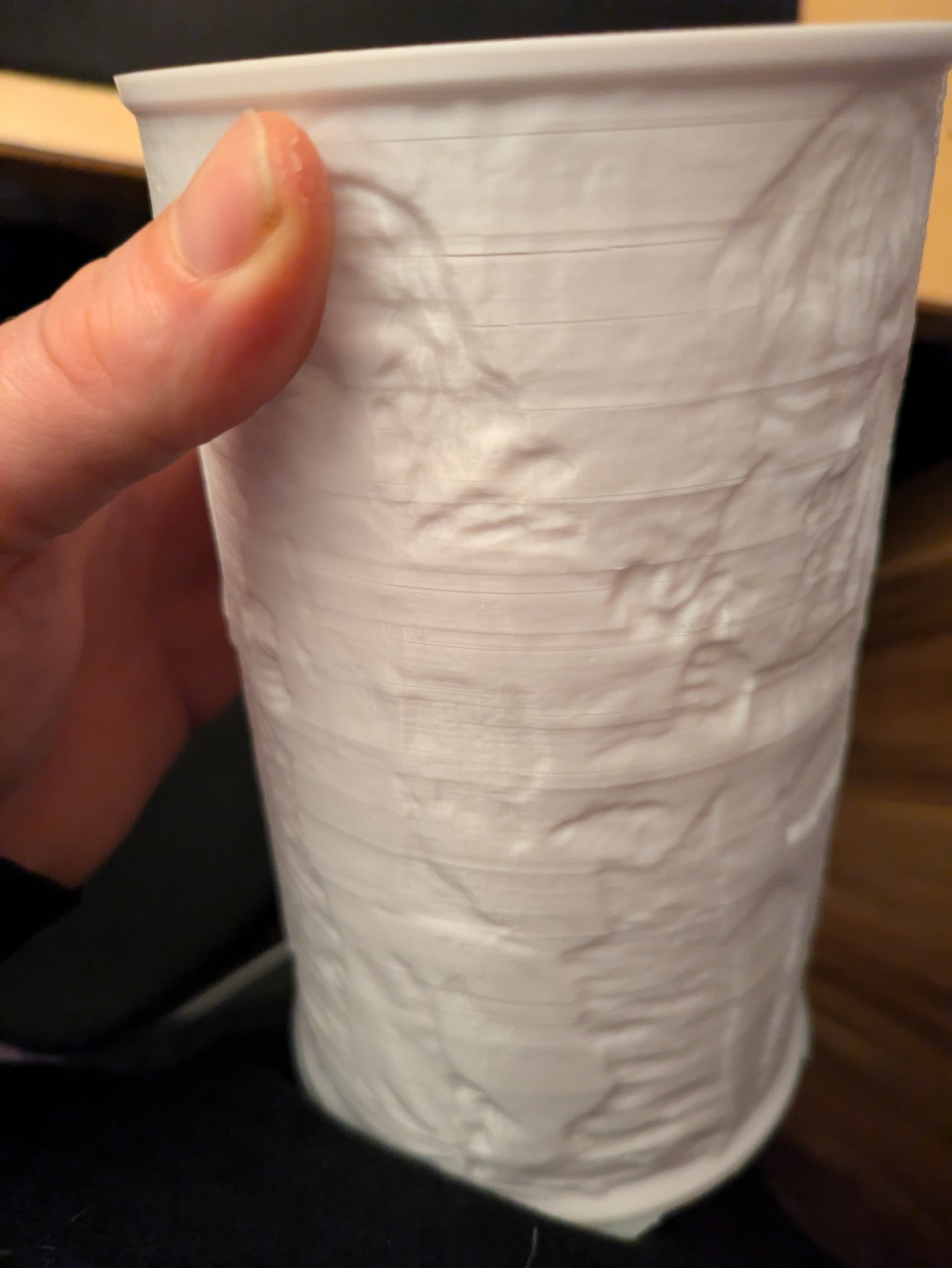

Well, I have tried your suggestions and the result is still the same :confused: My next and last solution is try and check extruder. I hope it works

After downloading your pic and checking it on the big screen it seems your layer lines split up.
So how about a simple test of increasing the nozzle temp by 5 degrees?
If those defects also appear in small scale it would be easy and quick to check.
That could maybe be wet filament. You could consider drying the filament and try again.
Print preview doesn’t show it. And layer gaps aren’t connected to seams. They appear anywhere.
I print normal pla with 220-225 degrees.
I testes a small cylinder and benchy. They printed pretty good. Big models always have this problem.
I also tested freshly opened filament but moisture doesn’t seem to be the problem
