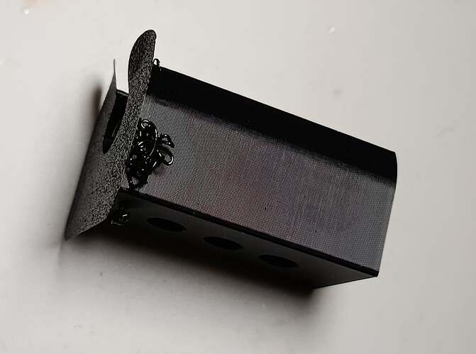

Hey everyone,
I’ve run into a strange problem with my A1 that just started out of nowhere. Prints will randomly turn into spaghetti, but bed adhesion seems perfectly fine. It usually happens on the upper layers, and sometimes it looks like the nozzle just digs into the print and shreds it apart.
Here’s what I’ve tried so far:
  • Build plates are spotless (washed daily with dish soap, then wiped with IPA, and I also use Magigoo).
  • Happens on both a smooth PEI plate with Bambu Lab Matte PLA (orange), and a textured PEI plate with Elegoo Rapid PETG (black).
  • I checked and cleaned the nozzle with an acupuncture needle — no clogs.
  • I also ensured the nozzle was locked and positioned correctly.
  • Re-ran all calibrations, including bed leveling.
  • Cleaned and re-greased the lead screws with the original Bambu Lab grease (thought it might be a Z alignment issue).
  • Both filaments were properly dried.
  • No errors or warnings … HMS is green and the assistant says everything’s OK.
The printer was working perfectly until a couple of days ago, and now this keeps happening.
Any idea what could be causing it or what I should check next?
Thanks in advance!
EDIT: Just tried to print a small rectangle box and the first layer is utterly terrible. I don’t understand, I just re-run a full bed calibration. The extruder is not slipping. I just sat there and watched it, but it looks like filament is not being extruded properly.
