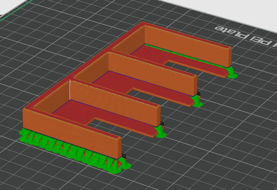

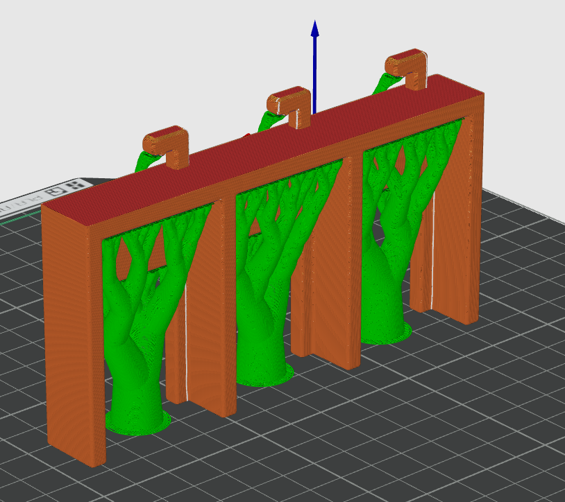

So I have designed a couple of parts in Fusion 360 and when I import into Studio and try to slice one part slices badly. If I stand it up it slices fine, but if laid flat, for optimum printing it seems to lose some detail and try to add supports. The second part of the design is a mirror image and slices perfectly regardless of oritenation.
Does anyone have any ideas? or is there a bug in Studio?

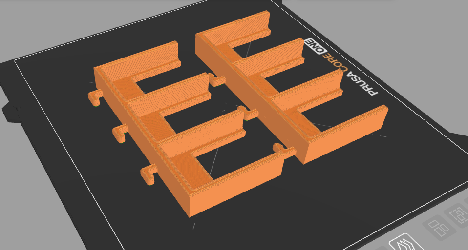

Ok, so using my limited access at work I was able to at least figure out that it isn’t a bug in Studio.

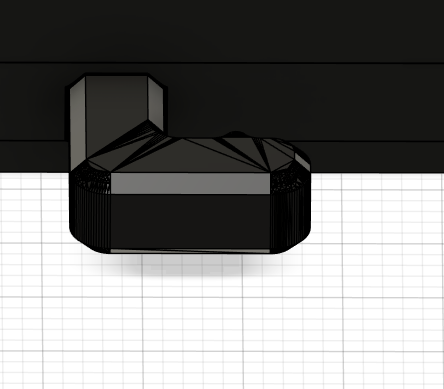

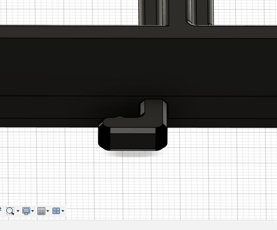

When I put it in Fusion everything looks normal except something’s going on with the side hooks on the version that’s generating the weird supports. Good one first below, then the bad one:

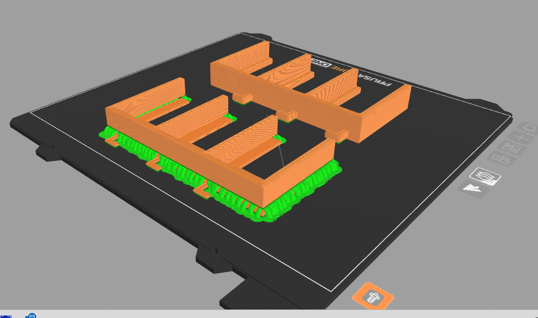

Then I realized I could slice them online using the Prusa web slicer (Sorry Bambu )
So it’s that part that has a problem. I went back in Fusion and mirrored the good part again. It looks ok now.
So still no idea what happened to that part, but all’s well that ends well? lol … Here’s the fixed step file, same as yours, inside a zip renamed to .3mf.
