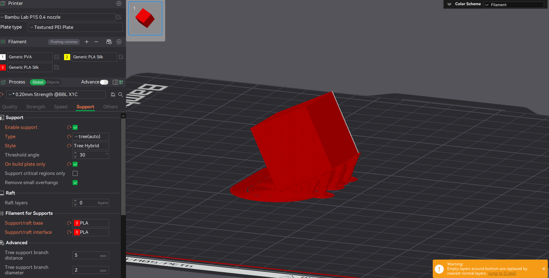

Slot 1 is empty, slot 2 has PVA, slot 3 has Gold Silk PLA, and Slot 4 has Red Silk PLA. When I refresh, only the 3 slots with filament show up which makes sense. But for some reason, the software is forcing me to use the PVA. For some models, I want to just use the same PLA as the model to help avoid waste and lower print times. I’ve tried setting it to default and the same slot as the PLA. So the model is Slot 2 and I choose Slot 2 for supports.
I’ve also tried changing and removing the PVA. If I remove it, it always automatically chooses the opposite slot for supports, so the model is slot 2 and supports are slot 3.
I’ve tried rebooting, saving/reloading, moving the models around to different platforms, etc… nothing works.
This just started today. I tried slicing the model with PVA interface supports originally but due to the print time, I decided to just go back to using the PLA for the supports on some of the plates. Even making sure that all the plates use the same PLA for supports doesn’t work.
How do I get this to stop forcing the support material? I could remove everything but the specific PLA but in that case, the AMS is now useless. I also want to be able to choose multicolor models and the PVA supports in the future so going to a single spool is not going to work.

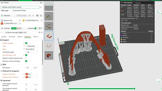

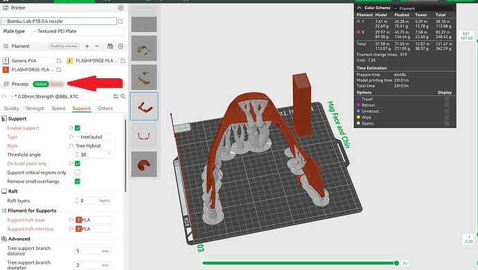

I noticed you have multiple plates. If you click on the part on the plate you are slicing and change to “Objects” instead of “Global”
8bc54fe953de2c31f2bcf17b9b6db145b375cd06_2_690x390
Check to see if the setting for “Filament for Support” is correct. The Objects setting will override the Global setting. This has tripped me up before.

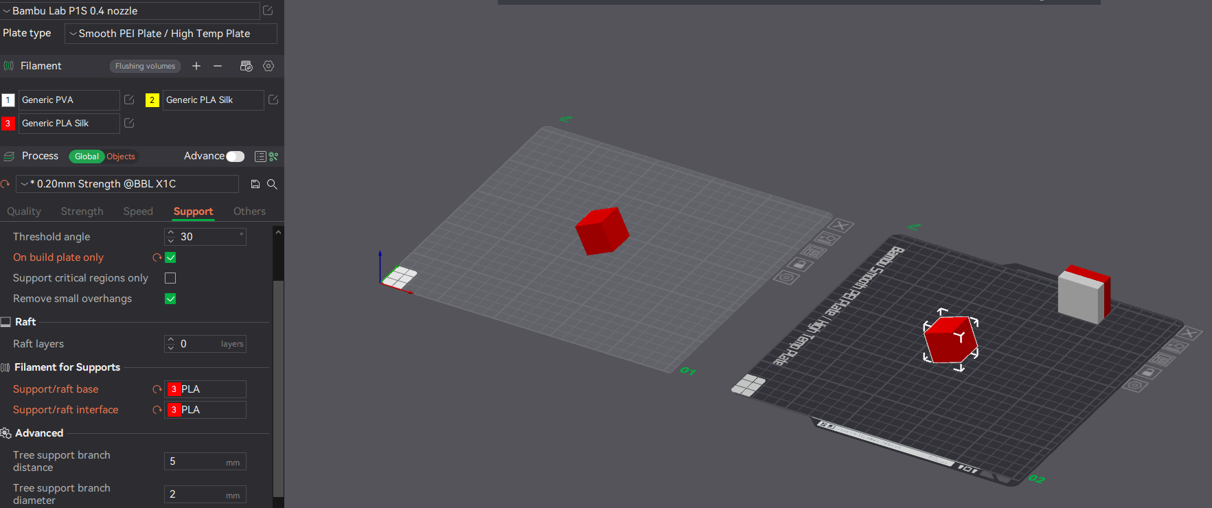

Example.
Two parts with “Gobal” set to PLA as support. The second part still uses the PVA.

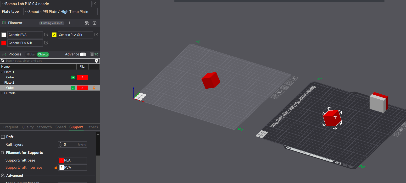

Then with the “Objects tab” selected.
yep. they were set correctly.

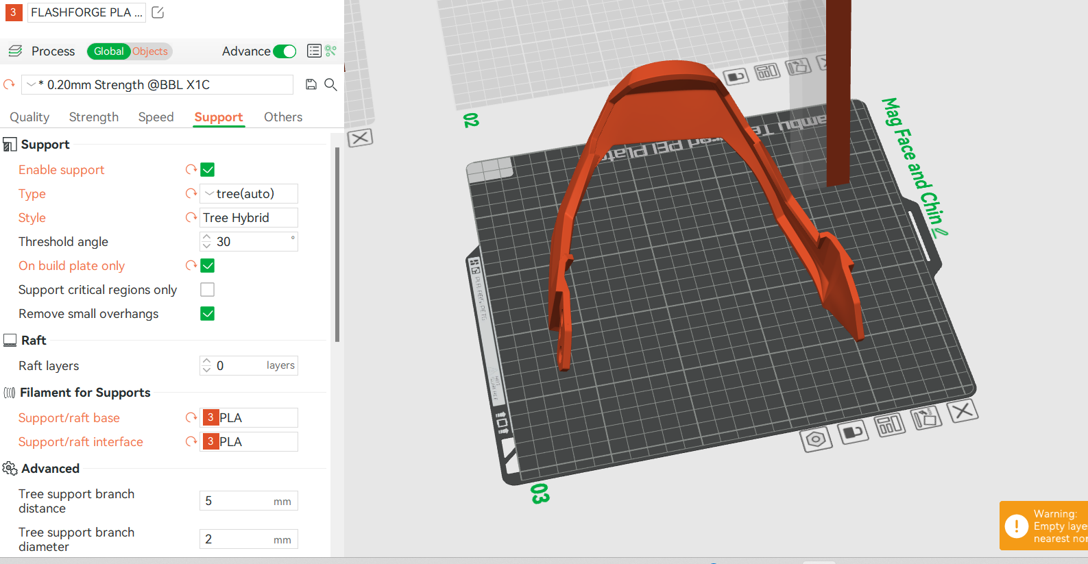

I tried one more thing.
Starting completely from scratch.
Redownloading the model then reorienting it, setting up filament, etc…
This cleared whatever the problem was.
