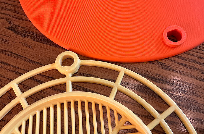

Well-dried PETG HF
Broken record, I know. But so many issues people post about here are due to inadequate drying. Here’s two parts just printed in Bambu PETG HF. Used the smooth PEI plate with glue stick. No lifting or warping. Prints came out perfect. The yellow and orange PETG HF spools both pulled the humidity below 10% in a polyethylene cereal box test with no desiccant in there to skew results before putting them in the AMS to start the prints. Just filament and a hygrometer.
