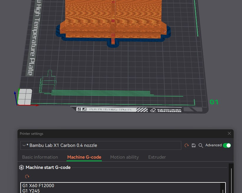

What causes the different extrusion test lines?

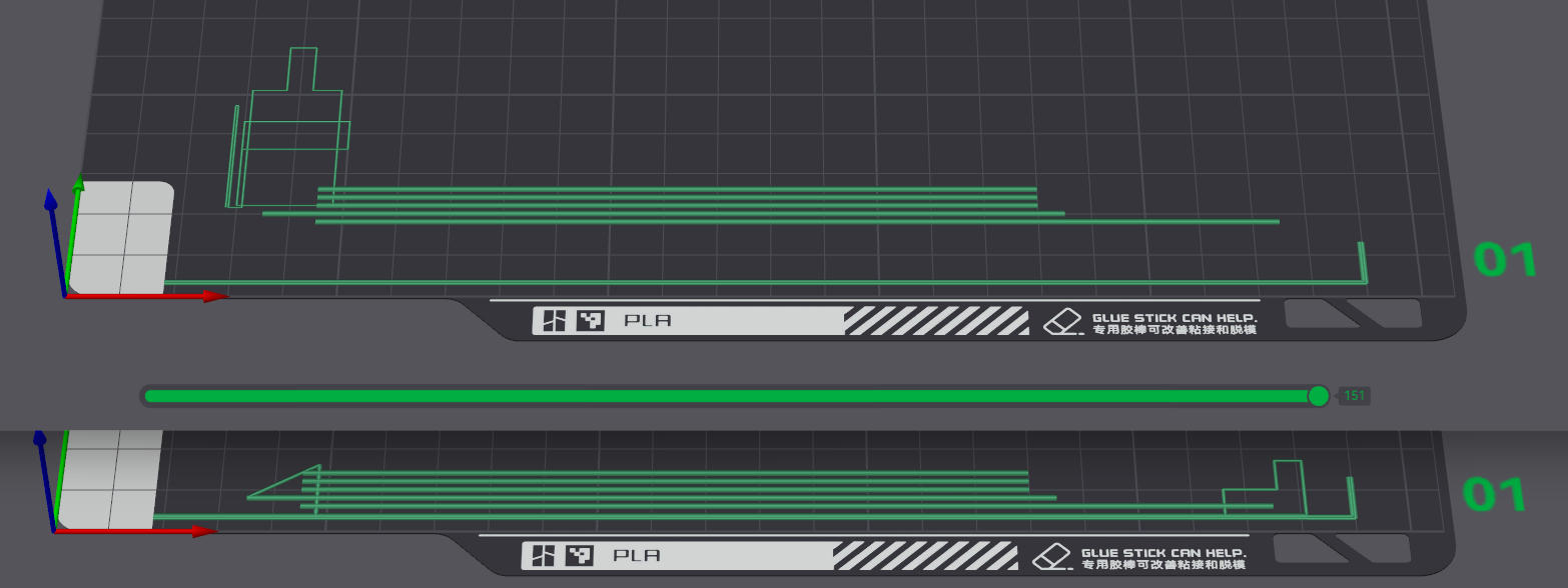

Just noticed that the lines look sometimes different. Does that depend on the features selected ?
Found it actually … seems a m3f downloaded seems to have been sliced using an older version of Studio which uses the older gcode for the calibration line
