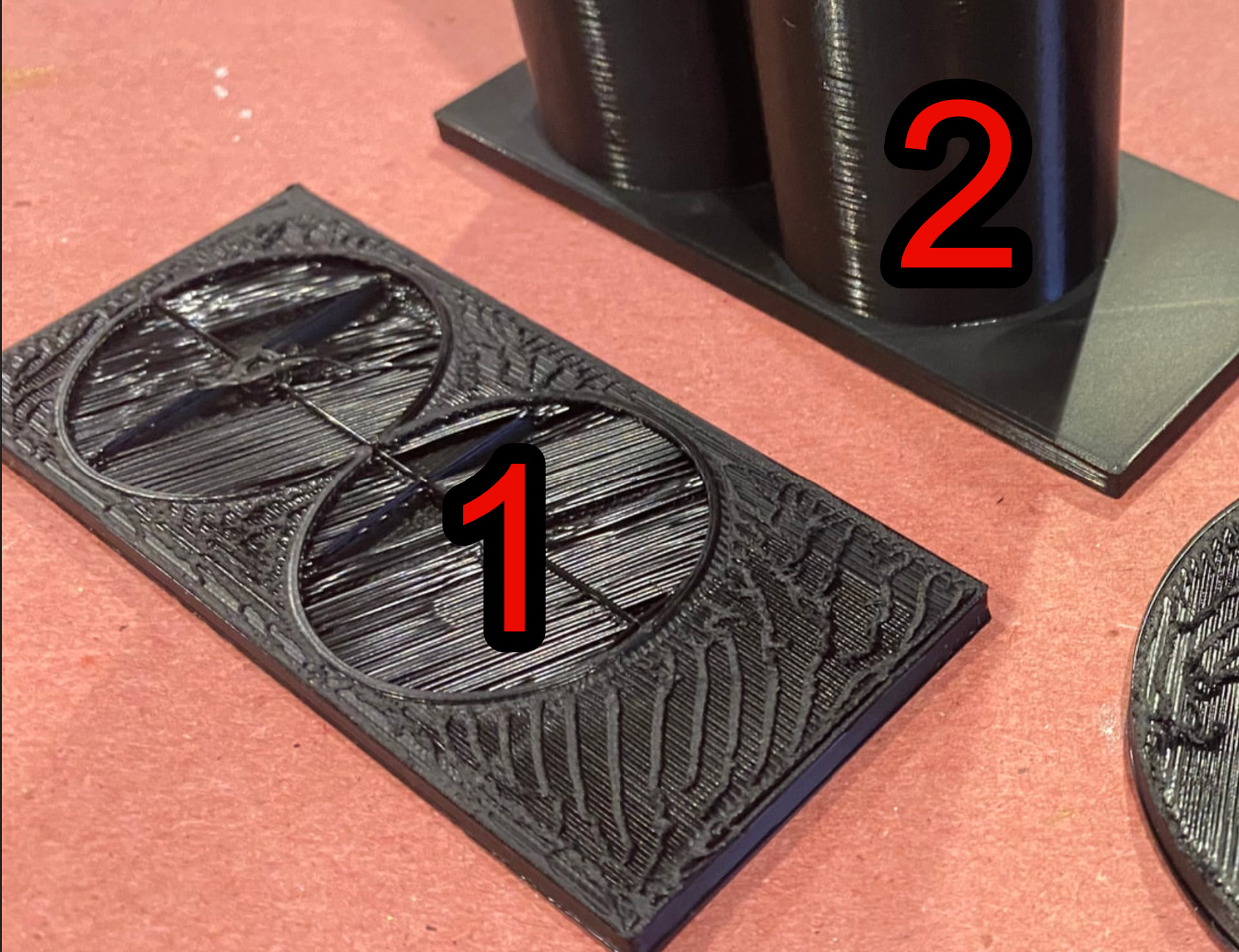

I’m using Bambu PETG Basic, based on the calibration tiles for ironing the best surface was the 80/40 setting.
I printed multiple parts that came out great on the previous roll of filament. Replaced the roll when it ran out and now the 2 prints I’ve printed have these rough sections. Not sure what to adjust… is it too much heat? Not enough speed? It’s not the entire surface of the pieces, although this last piece it’s most of the top surface.

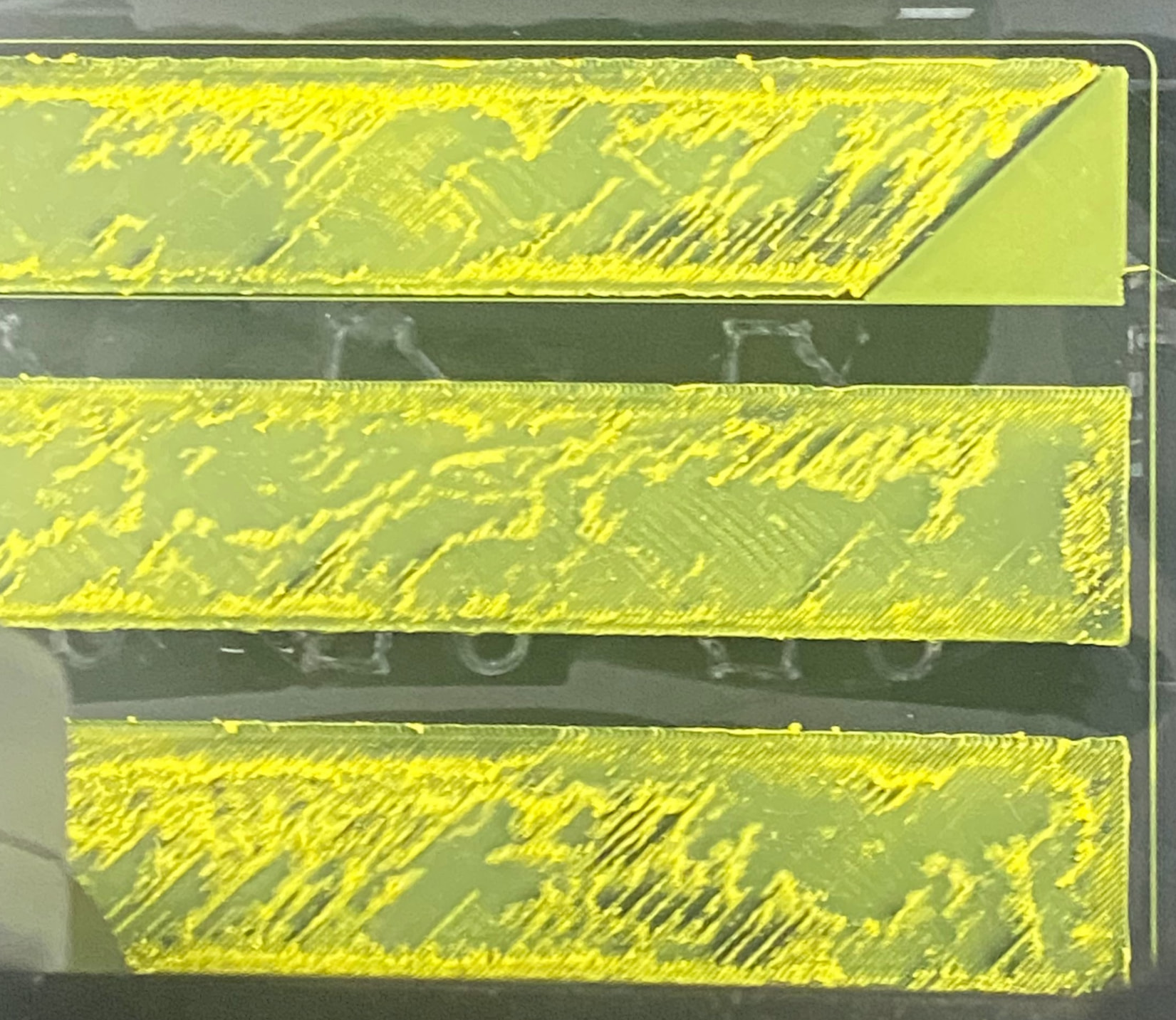

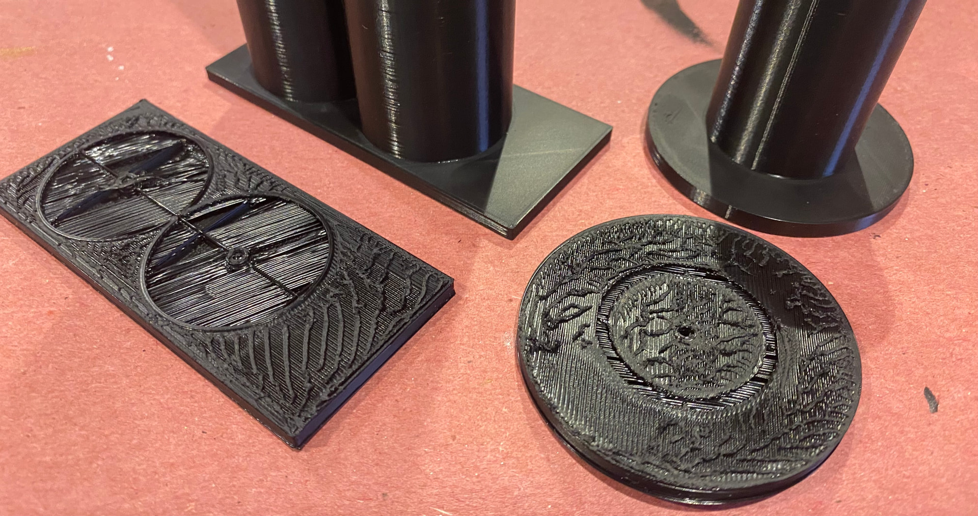

Today I had a new roll, ran through a drying cycle… same file, same print, same identical result. The print is basically perfect until it irons. The ironing produces an almost identical blemish and then continues to print nicely until it reaches another section for ironing and again it does that section perfectly.
I then ran a job with a different file/part… same results… print goes perfectly and the ironing results in the same flaws, then it continues on to print perfectly fine again.
Im waiting for this print to complete to go back and run the one I had success with 2 days ago to see if that will complete flawlessly.

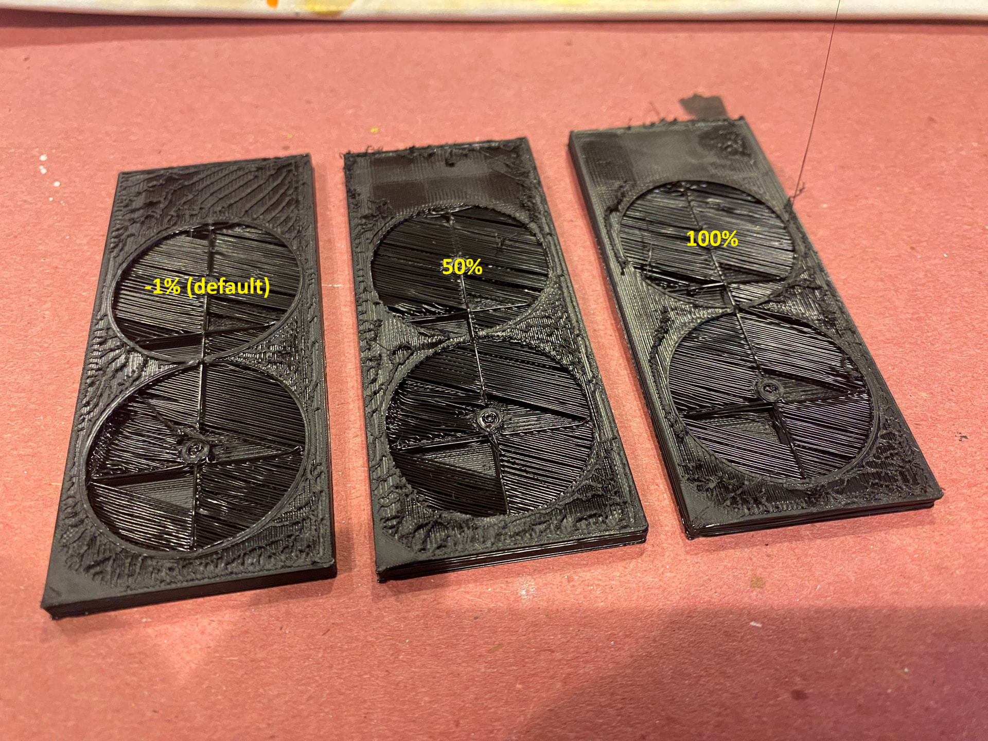

Attaching pics of todays part (identical to yesterdays, its so similar that I had to check timestamps on the pics to be sure its not a pic of the part from yesterday), and the second/different part…. something to note the nozzle is moving perpendicular to the lines, not parallel to them as they appear. The print would have been fine if I had ironing turned off.
Thanks for the tips, Im going to try these suggestions. The hygrometer in my AMS usually sits at 10 (I think it bottoms out there), its been at 20 while I ran all these prints that gave the same issue/flaw.
