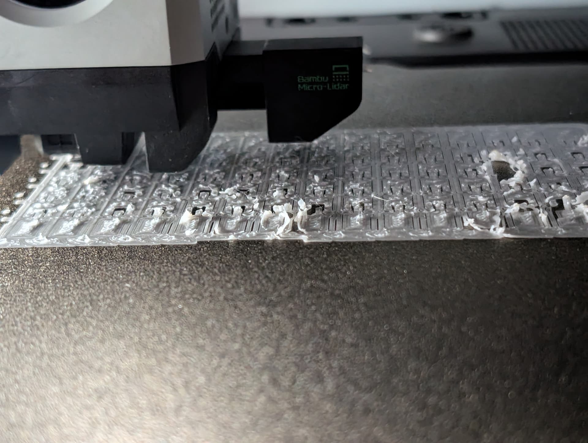

hobbiest x1c printing pla -printed the rest of the model with same filament yesterday - no printing legs and ive tried 2 different plates, smooth and textured Pei
I did a cold pull to clean the nozzle
the filament is dry
I keep getting this stuff w this model - yesterday it printed perfect - I just need more legs
Maybe i need to print the first layer thicker ?
Temps 220 and 55 degrees

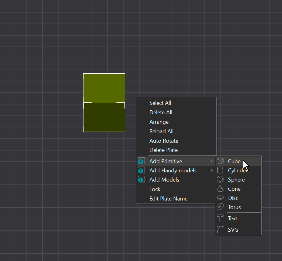

Right-Click and create a cube primitive.

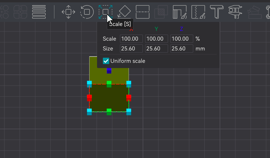

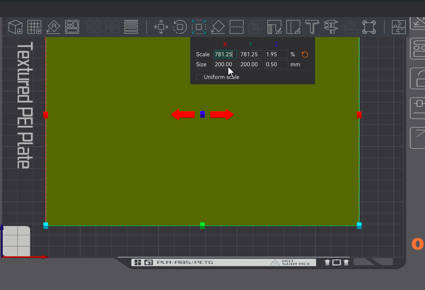

Select the cube and select Scale. Scale it to 200x200x0.5MM and center it on the plate.
Print the object and take two photographs to be posted here:
