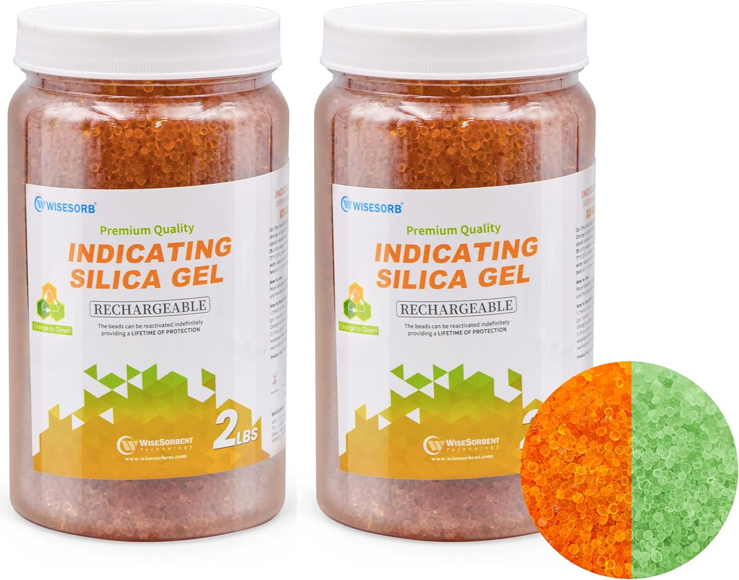

For anyone interested, the one I picked was this:
which, if I’m not mistaken, does use Chlorophenol Red as the indicator and also has the smaller size range beads (2mm-4mm). That compares with the dry-and-dry brand, which uses methyl violet and has the larger (3mm-5mm) size range beads. Prices are the same either way.

The packaging didn’t specify, so I compared a sample of each. They look the same size to me. I would guess they are the 2mm-4mm (I didn’t pull out my calipers to confirm, but they didn’t look large enough to reach 5mm). But I have been super happy with them.
