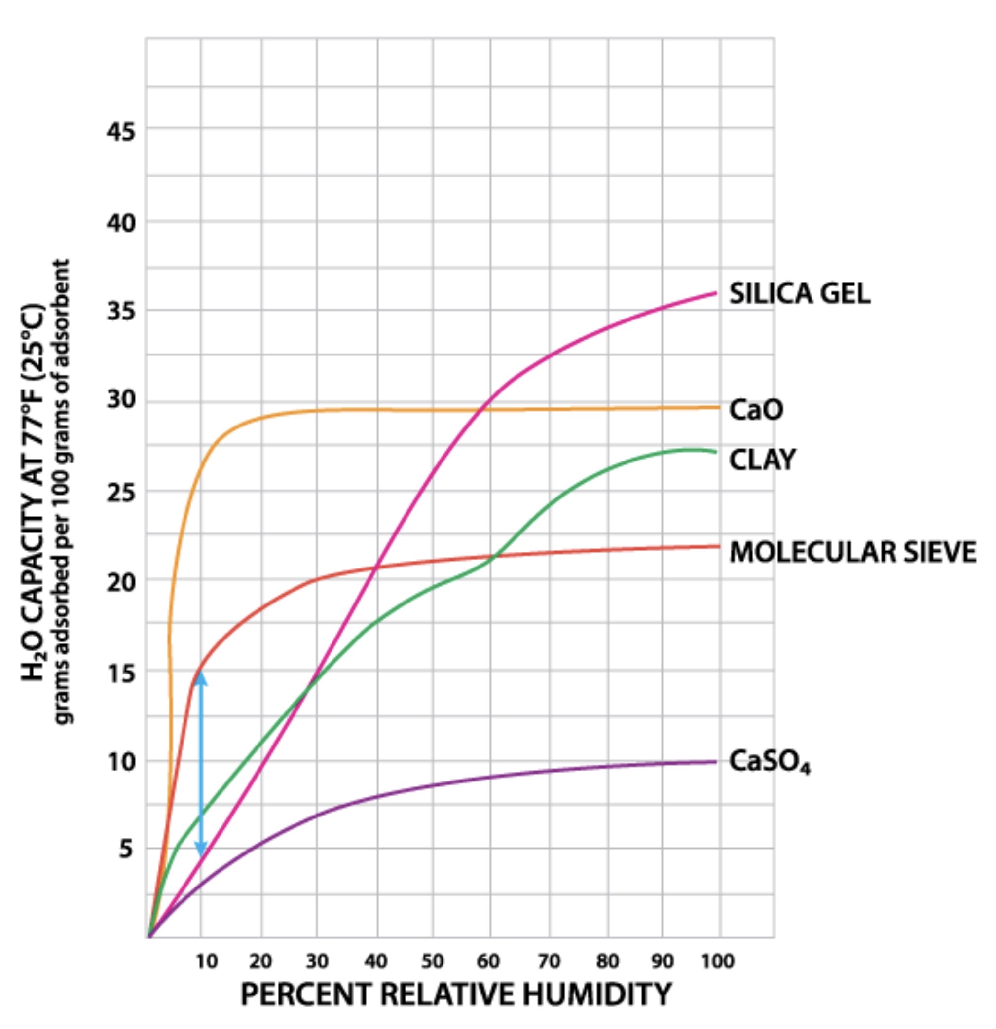

Here’s that as a graph. One thing though is silica gel can pull humidity down close to 0. All these desiccants can. It’s just that as it picks up water the humidity it can pull to gets impacted faster than with others like molecular sieves. (Another way to say it.)
All of these can pull humidity down to near zero, though. It’s just molecular sieves will hold near there longer as it picks up water. It’s more of a capacity issue than how low the humidity can go.
So Molecular Sieve is 4X as effective at 10%RH, but above 40% Silica Gel wins (and is rechargable at home). Of course, Calcium Oxide wins at the low ranges we’re aiming for(*) but try to find it anywhere in retail quantities, and then it’s not rechargable…
(*) I’m not even sure what range we’re aiming for, but 10% probably isn’t awful. [Yes, I mean 10%RH in the air after enough time has passed for the air, desiccant, and filament to equalize.]
Filament doesn’t need to be completely dry to print well. Actually, completely dry is kind of a misnomer. Like so many things there are diminishing returns involved. The last water is held much tighter and is harder to remove than the first water that comes off. There will probably always be some water in filament no matter what we do.
What to aim for to an extent is just what prints properly. More dry than that gives headroom for water that leaks back in though. Headroom is good so you don’t always need to re-dry.
And last, relative humidity is highly dependent on temperature. When specifying an RH% you always want to specify at what temperature. When I dry PLA, for example, I dry to 19% humidity at 55C. When the spool cools in a sealed poly cereal box (without any desiccant) the humidity pulls down below what my hygrometers read - 10% at around 25C.
For storage, though, I use 50g packs of silica gel in those poly boxes to scavenge water that leaks in. But just for testing humidity, no desiccant is used or it would overpower the humidity from the spool.
I think it is not only capacity but also adsorption rate. At least in my experience, molecular sieve reduces humidity at a very constant rate down to zero. Silica gel becomes slower and slower until it stays at an equilibrium around 10 to 15% RH.
Actually, the capacity has virtually nothing to do with adsorption/absorption rate. Those humidity vs moisture content curves are at equilibrium all the way.
I think what you are saying is that moisture content changes linearly with humidity at low humidity/moisture content.
Discussions about rates have very specific places in chemistry and physics so you have to be careful how you say things or else it can be misinterpreted.
But back to point, those curve shapes reveal some chemistry going on. I haven’t looked into it but the molecular sieves curve can really be broken into three different somewhat linear regions. At first blush I’d say there are at least three kinds of sites where water sticks down each with different strengths of bonding. Silica gel possibly has just two (though there could be more with similar energies). The first sites populated will be the ones that hold water the hardest. Next up are the next strongest, etc.
Along with bond strengths there probably are rate differences too but that’s not contained in humidity vs moisture content curves and there’s lots more involved in reaction rate discussions.

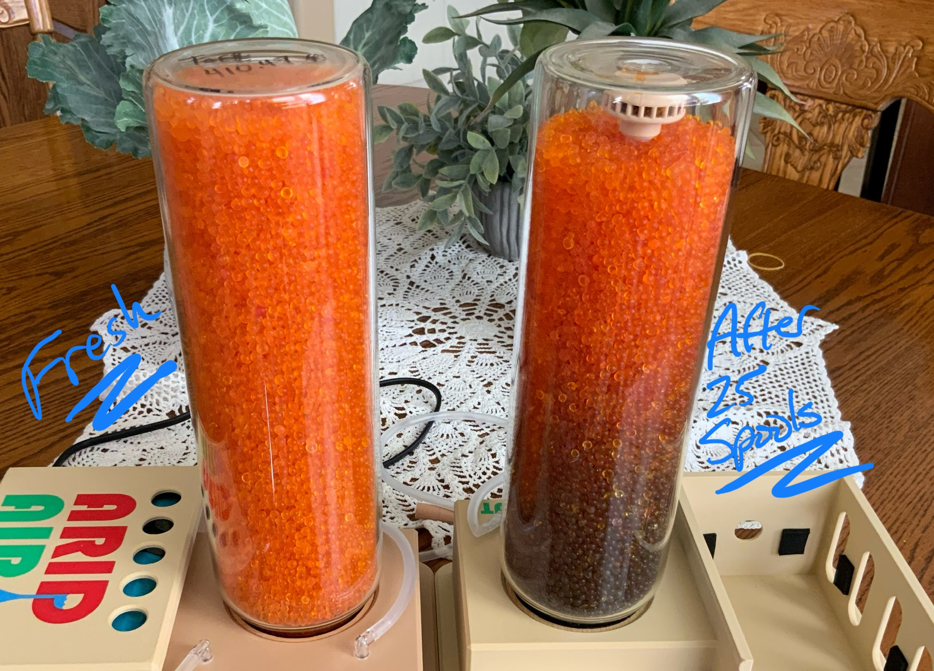

Ah. Did you still have the pouch desiccants in there or just silica gel or sieves? Rates may be playing a part but in an AMS or in a dryer where there is a source of water (filament/leaks) it’s a dynamic situation and gets hand-wavy.
Your reasoning on the column is absolutely correct. I use all indicating beads in my air dryer and does exactly as you describe. The water largely drops right out so a gradient sets up in the column. Air moving through sees progressively drier beads so itself gets drier and exits at the humidity of the beads at the column exit.
It’s pretty cool to see how it behaves as I use it. Also, there is a big design flaw in the photo. Humid air rises. Water vapor is more buoyant than O2 or N2. Humid air should enter at the top of the column so the most humid region is at the top. The way I did it for this photo is to add humid air at the bottom. In practice it isn’t a big deal but there will be a contribution to shortened column life from water vapor always trying to rise. It’s a little like always having a low flow of air going through.
Also, sorted getting longer life out of the beads by not running dry air the first half of the dry. Water is coming off the filament fast enough that propping the door on the dryer open a little does a better job of getting the water out. It roughly doubled the column life to around 50 spools dried to look like the photo. There’s not much water in room air so a charge of beads can generate a lot of dry air before getting saturated.
Got a better new version that fixes the flow direction and simplifies things.
This is like using silica gel beads or sieves in a dryer or AMS and is the problem with loading them up with desiccants. They all start coming up in moisture content and their humidity value starts climbing. Keep them more dry than you want the chamber humidity and you’re golden. Let them pick up too much water and they can become sources of water too and slow drying or hydrate filament.
But how it behaves will follow those curves but those curves are for equilibrium. In dynamic situations where water is leaving one thing and being picked up by another you can see humidities that aren’t at equilibrium and then the rate stuff can certainly matter - as you mentioned.

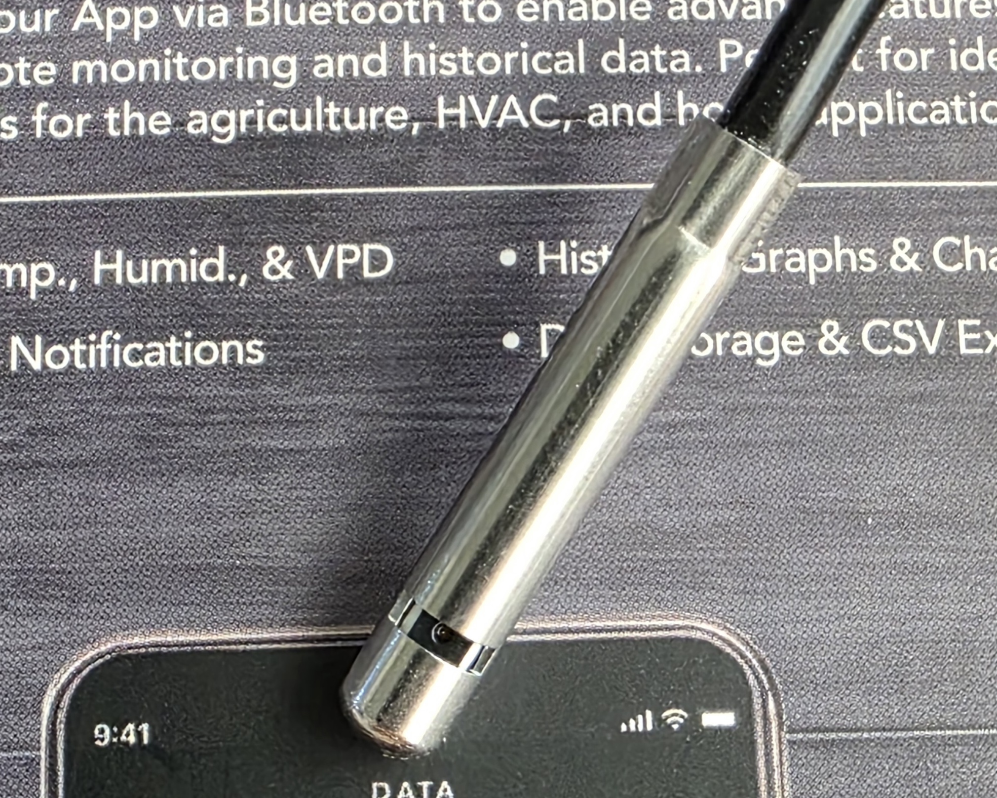

By the way, I just today received this TH sensor that includes the humidity sensor in the probe tip. It can withstand up to 90C.

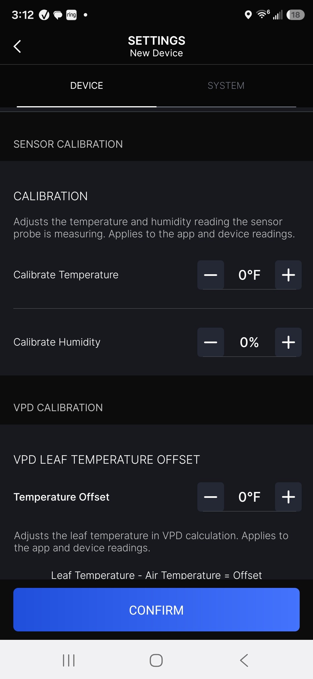

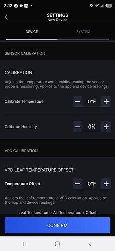

The app is nice because it allows for humidity calibration, should it be needed.
