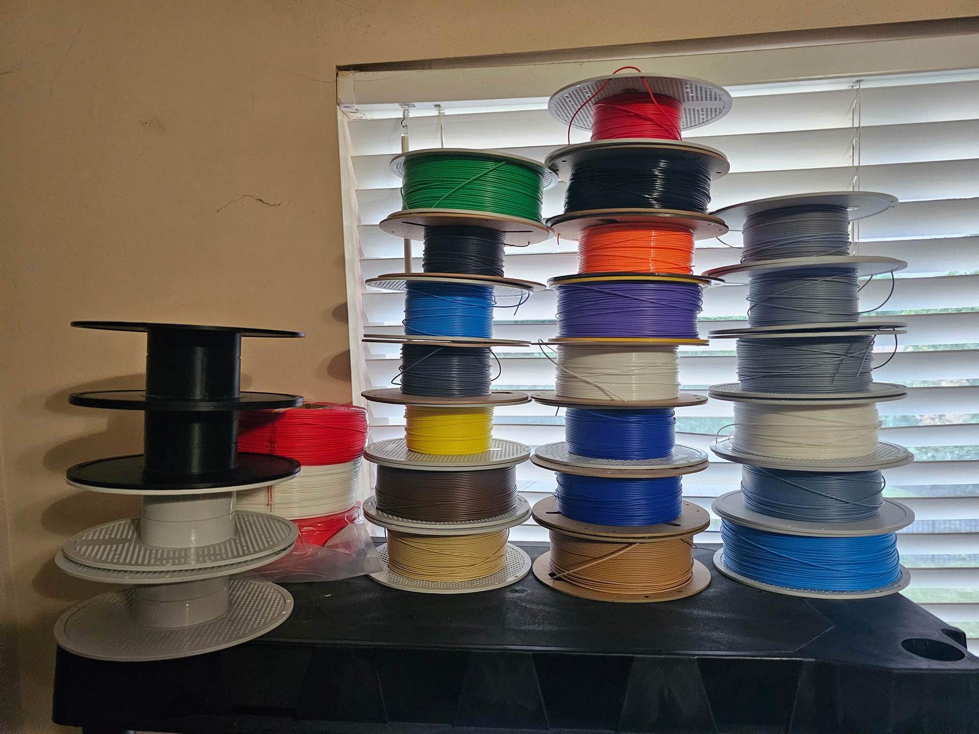

People will hate it, but here is how I store my PLA…
It happens. Especially with partial spools you hope to “maybe someday” use up whenever the need for that particular color arises (and then never does).
That’s why I have high hopes the CMYK approach will solve this. At least it can maybe cut down on all the leftovers. Yet, I doubt it will ever give an orange as bright as the one in your photo.
Whatever works, I suppose.
I’d at least put it in something to keep the dust off.
