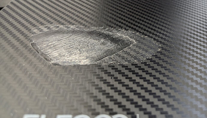

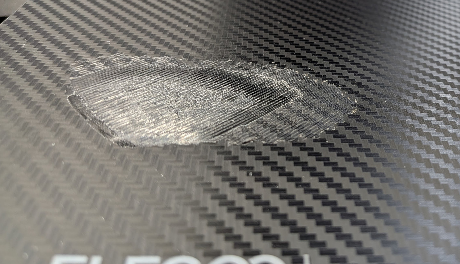

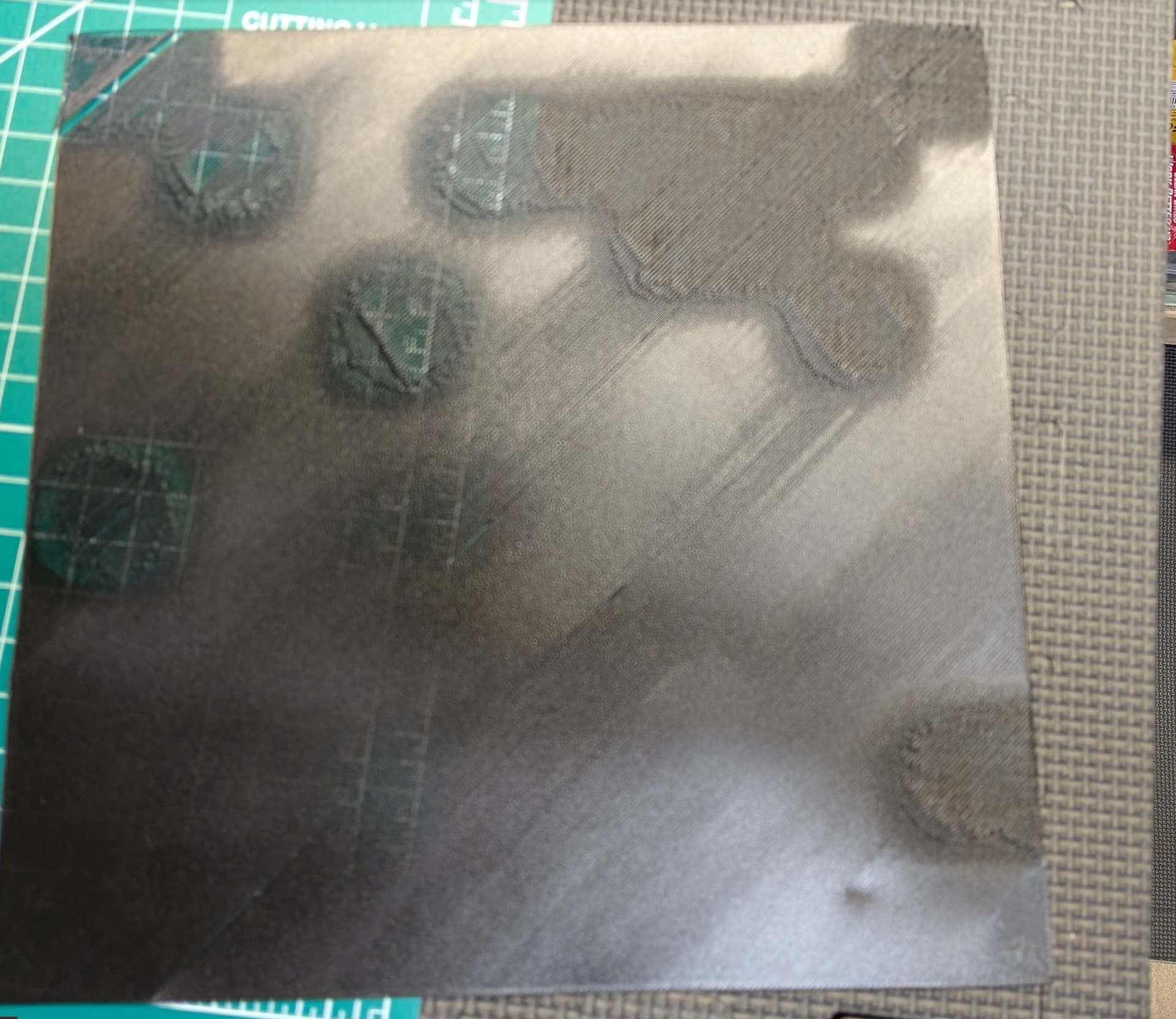

It can fail in one of a couple ways:
  1. detected failure, it will throw an error message, and complain to you. 99% of scenarios fall here, bambu firmware really likes its sensor data and does not go happily without it
  2. undetected failure, it will successfully calibrate badly.
    2a) it will set z offset bad, and either fly far above the bed spilling loose spaghetti everywhere, or will dig down too far and destroy your bed.
    2b) if it gets far enough and creates a bed mesh of bad data, this is what that often looks like. Those are “raised” areas that [faulty] bed mesh sensor said was ++++height. This is unlikely to happen on bambu a1 since it taps to level and the sensor is in the toolhead, it will fail earlier
    2c) something else :slight_smile:
