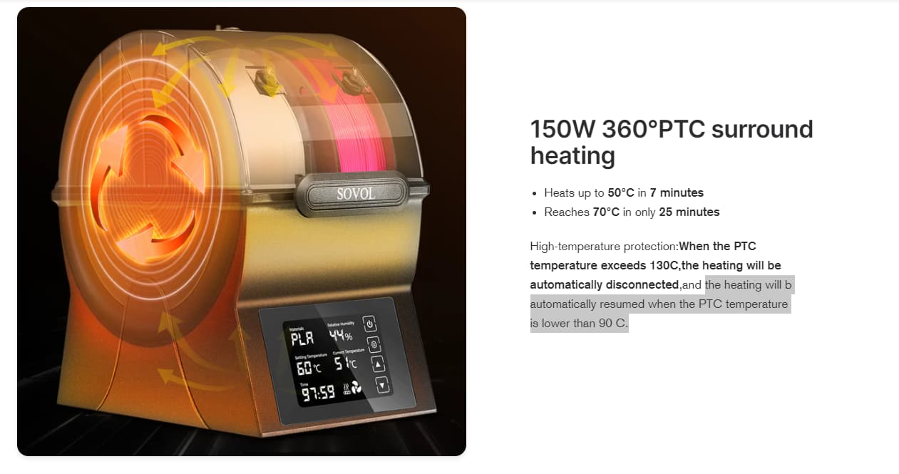

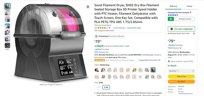

Meanwhile, I had a look at Sovol’s new filament dryer. My god, I can’t believe it ever passed any kind of product safety review. For levity’s sake, have a look at the description. I even highlighted the obvious problem!
Anyone see the problem here? Hopefully everyone? Let’s recap: the user can only set the drying temperature to between 40c and 70C. If you buy this device, that means that the range you want to dry filament at. Not higher. Not lower.
Problem #1: The safety feature that it brags about having is that it will turn off if it detects the temperature has reached 130C. Hello? Are you kidding me? The filament this was designed to dry will possibly (likely?) be fused together and ruined by the time it kicks off. Plus: will the plastic enclosure even withstand that kind of temperature? I hope sovol picked a suitable plastic to manufacture with.
Problem #2: It says it will resume heating when the temperature drops back down to 90C. WTF? Really? That is still far above the maximum possible target temperature, and it’s going to resume heating. Why? How does that make sense? I just don’t understand how China designs like this ever get put into production.
After looking at this, I will never buy a Sovol product. Ever. I don’t care what the reviews may be like for their printers or anything else they may make. I believe in the Zen proverb: how you do anything is how you do everything.

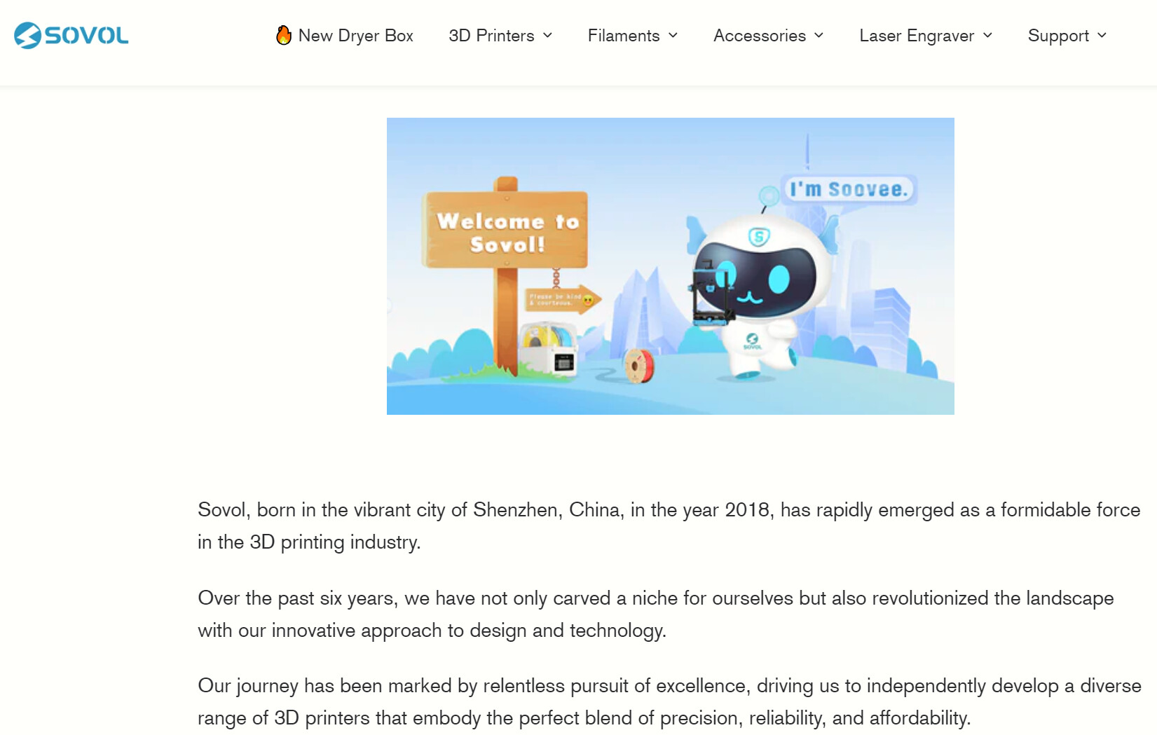

This product photo isn’t even real. Can’t everyone see that this is a computer rendering with very bad photoshop on top? Who falls for this kind of scam? I guess a lot of folks because it “Looks” cool. Sad. :disappointed:
Add to that the fact that a number of their web pages are blank such as the Intellectual Property page and this gem of a marketing blurb. “Formidable Force” you say? No kidding. :crazy_face:Keep pouring that Kool-Aid. PT Barnum was right.

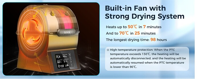

Maybe so, but apparently the product is real enough that you can buy it on amazon:
and get it delivered in just two days. :roll_eyes: And the amazon product listing makes the same claim as what’s on the official sovol website. Here it is:
It re-affirms that it’s the PTC temperature that’s being measured, rather than the interior air temperature (thank God), but still…

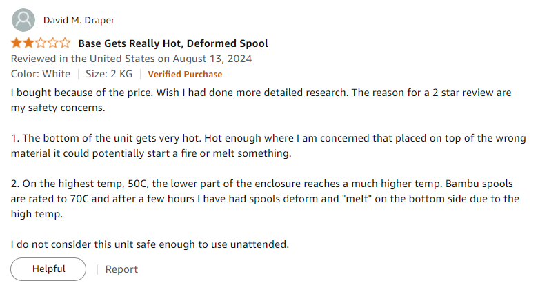

One of the amazon reviews raises another possible issue:
I don’t own it, so I can’t confirm or refute, so about all I can say is: caveat emptor.
Anyhow, imagine the PTC temperature went as high as 129C and then stuck there, never quite getting to 130C. Hmmm… What happens then? Is there no failsafe for that failure mode? Or the range of ones similar to it?

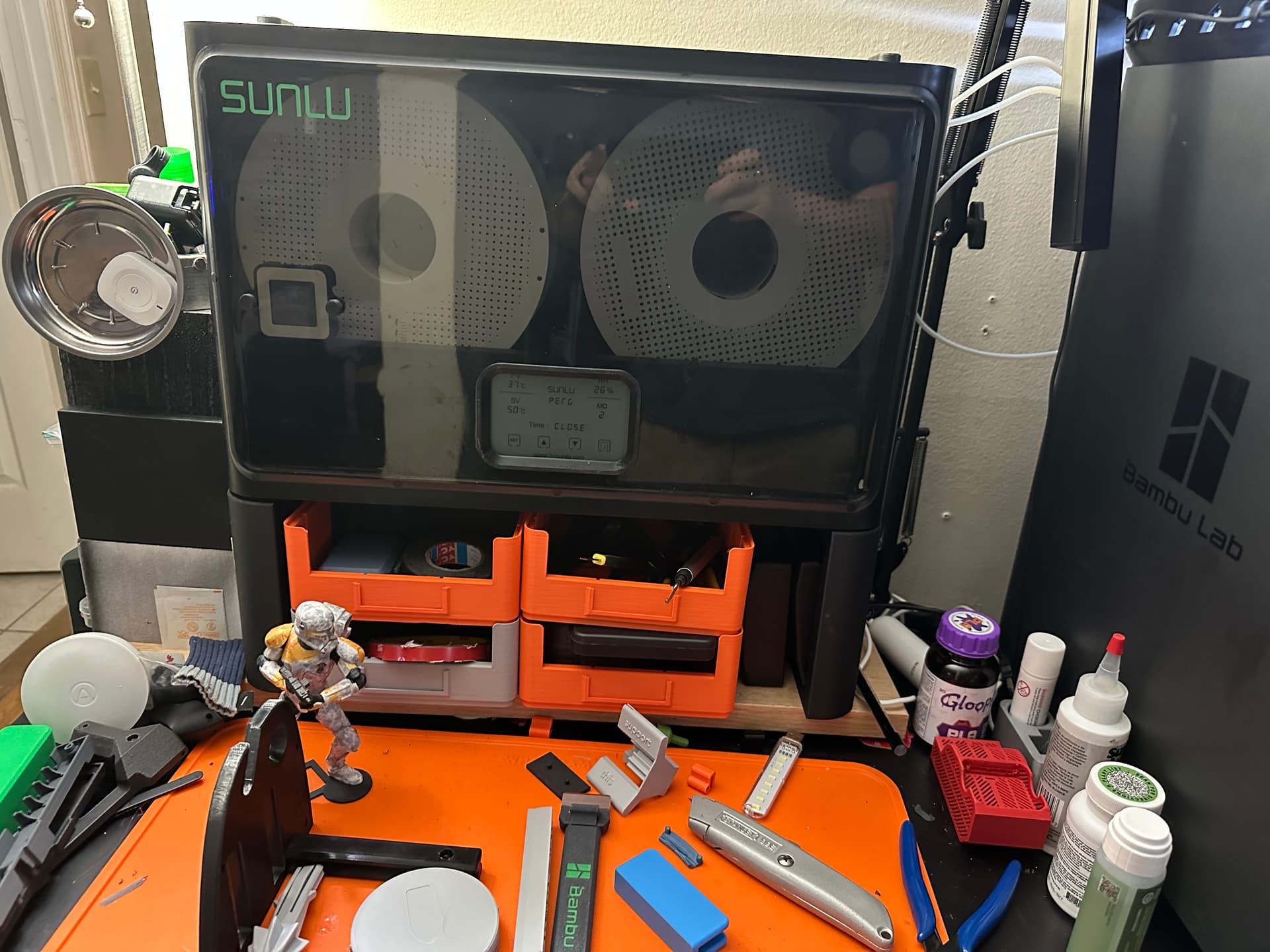

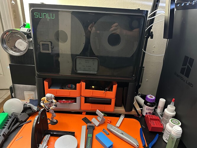

I’m a fan of my S4. Use it as storage and a dryer. Also dries the desicant that goes into the AMS.
Forgive the mess.
