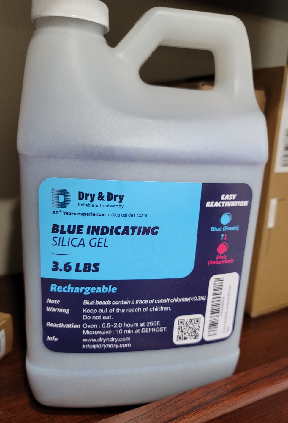

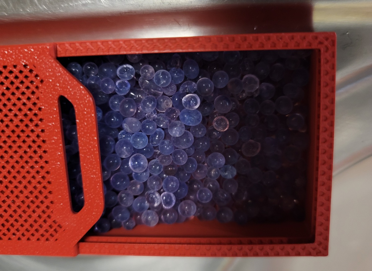

Get the color changing dessicant and then see how much they absorb. I think you’ll lbe surprised.
I’ve got the Deep Blue —> Deep Pink Dry & Dry brand.
20 Days
But since I like my thermostat set to “Teeth Chattering” My baseline humidity is low.
Well what I mean is you’ll see that it absorbs moisture within the AMS.
Does it make a huge difference? I’m not so sure, but it does absorb. I have been back and forth a few times on taking them out, but in the end it doen’t hurt.
