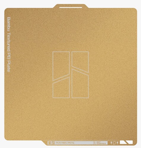

I have noticed that the new Gold PEI plates have a pattern in the middle. Anyone had problems with the pattern coming off?
Not sure what pattern youre referring to. I do not have an identifiable pattern in my gold or black plate.
I’m glad I bought a black plate before these became available. I have to think the image becomes molded into the bottom of the prints.
Haha wow! THATs what you mean by a pattern :laughing: I think I purchased mine before they started putting that Bambu logo in the center. But, having worked with PEI plates with similar logos, I can offer my experience. If there is any logo, pattern, etc on the plate it will come off in my experience. I’m really not sure why they bother putting it on at all
I think the design is etched onto the steel sheet before powder coating so it “shouldn’t” transfer to the design. That being said, I bought my gold textured plates before the design was added so I have no way of testing this theory.
haha. I didn’t realise it was the Bambu logo.

If I get a Gold PEI Plate from Bambu I don’t trust the logo not coming off onto my prints. As I said earlier, it happens with my Engineering plates, where the text came off, so I’m presuming it’s going to happen with these new Gold Plates.
There are other places where you can get Gold PEI plates for the Bambu. Has anyone bought one from somewhere else that was good?
You’ll be good. The logo is made with the PEI coating so it’s debossed into the texturing. Only way that’ll go away is if the texture goes away
My newest X1C came with the gold PEI plate with the logo. While the logo and the words on the side are etched in before the texture and thus do not affect adhesion, the logo does show up on the print. You do have to look for it though, tilt the print in different directions to find the imprint.
