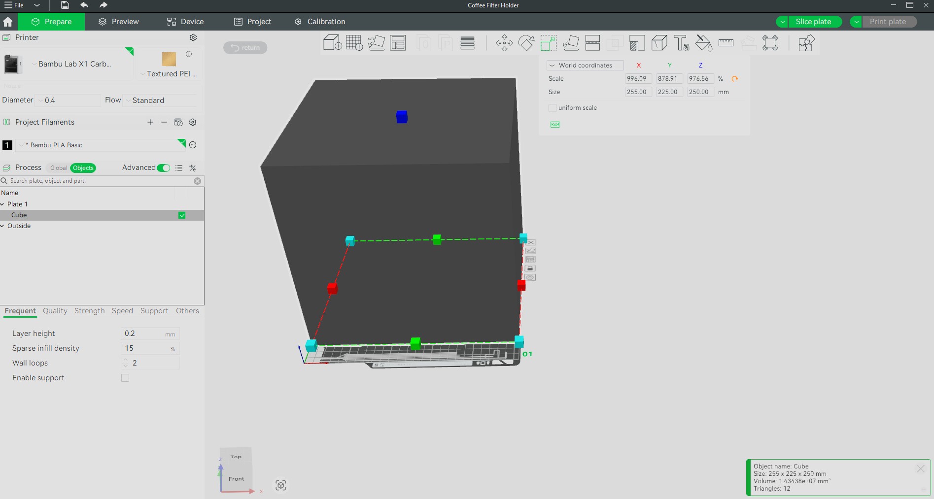

While I understand that my answer below does not directly address the OP’s question, this is where a Google search led me when I queried the post’s title question, and the answer I sought is provided below. I hope this helps others who find themselves in the same position I was in six months ago.
If you prefer to keep your printer unaltered as it is when unpacked after delivery, and you’re not interested in following the wiki’s steps for achieving the “full” advertised print size or altering the flow lines area, I recommend designing your models to fit these dimensions:
  • X: 255
  • Y: 225
  • Z: 250
As shown in the screenshot, you still have a little play in the front before impacting the flow lines (if your design isn’t cube-ish).
When I started my journey in 3D printing with no prior experience, I had just purchased my first printer (X1C). This was the kind of information I was eager to find online. Although I still see myself as a novice in this hobby, creating designs within these build plate dimensions has been effective for me so far, and I know that if the need arises, I can make the wiki adjustments to utilize the entire print bed.
