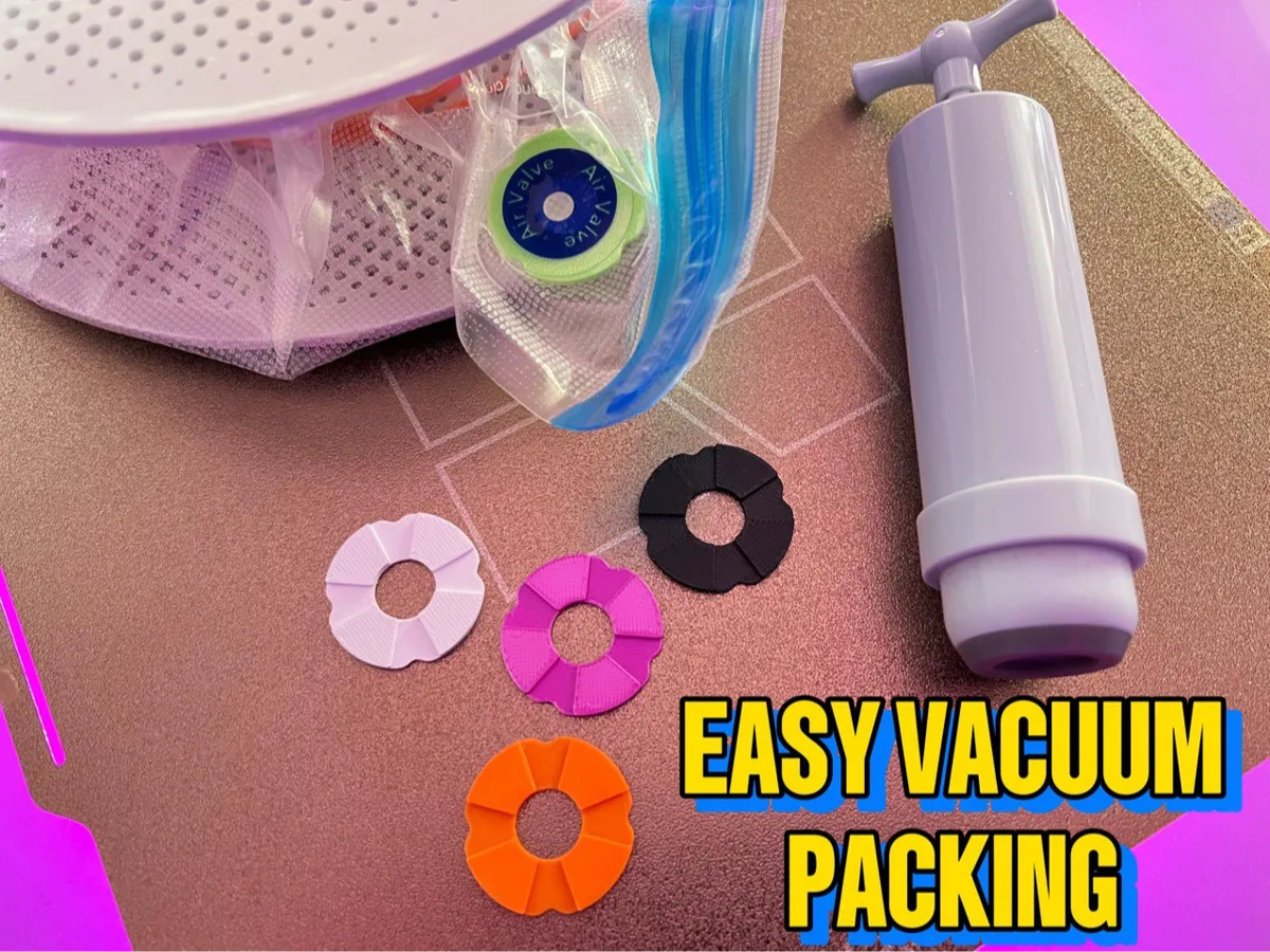

I try to store my filaments in zipped locked vacuum bags. But vacuuming them is really hard. I tried manual pumps, and usb charged one (the one in the pic), my kitchen type vacuum machine with its attachment and even with vacuum cleaner.
When i watch 3D printing videos showing this approach, all they do is; they lay the bag flat, put the usb pump on the hole and start pumping. In my case, in all methods except vacuum cleaner, pumps fail to suck even a tiny bit as if the hole is closed. The usb pump works perfectly on purpose build food storage boxes. Also worked well with the jars and covers provided but not with bags.
Even the vacuum cleaner can not start sucking immediately and i need to squeeze and manipulate the grid part of the bag. Once it got the hang of it, vacuum cleaner sucks the hell out of the bag. So i know that zips are perfectly locked and bag has no puncture.
Is there something i miss like priming the suction hole. What is the trick.
Carrying the vacuum cleaner around the house just to vacuum a bag i will reopen in a few days becomes tedious.
99% of the time, I have no problems…but sometimes the hole is closed & you just need to lick your finger & rub it…I’m not making a joke, sometimes you have to get it wet.
If you’re pushing down hard with the vacuum when trying to pull air from the bag, you may be sealing the hole against whatever is inside the bag. If you’re pressing the area around the hole down tight against an underlying surface, little if any air will to get past that seal to be extracted. Works on jars/lids because pushing on them doesn’t deform them like the plastic bag can be deformed…
You shouldn’t need to apply any pressure, the act of turning on the vacuum pump should suck the bag up tight all on it’s own.
If that’s what you’re doing already, then I got nothin’.

Water is a very good insulator as well. I did not lick any thing but used some “tap water” for the effect . It did not worked either.
After posting my OP, I compared the bag with the vacuum bags i use kitchen vacuum sealer. The grids for the machine are much bigger than the ones on these zip lock bags. So i decided to make a test. I put a piece of tissue paper under the hole which will create a better space for air to be sucked out. It kind of worked. I managed to suck the air out with USB pump sufficiently. Then remove the tissue and retried it. It did work but it was much slower.
I tested one other variable too if i put the bag on a hard surface and pres the pump down tightly it can not suck anything. If I put it on a softer surface like a mouse pad and press gently it works.
I do not why they prefer to do this way but finer grid of these bags just do not allow enough air to come out and if forced harder, the two faces of the bag totally blocks the hole to work.
