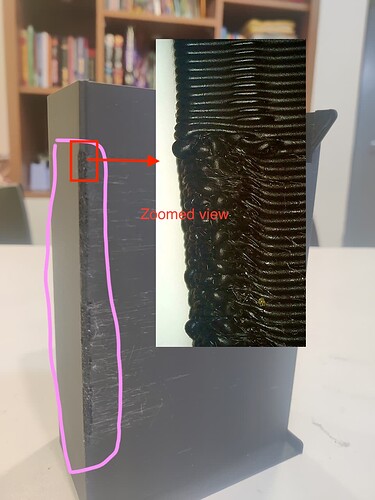

So, I changed flow rate based on calibration earlier it was .020 and now I set it to 0.30. Print is better than earlier at lease no broken joint. But area marked in pink lines its really very rough and not uniform, left side marked in pink area is where z height adjust for nozzle to move onto next layer, and at top corner is smooth but same issue happened at right side marked pink area.
Look like when printer adjust height to move to another layer there is some issue at the point.

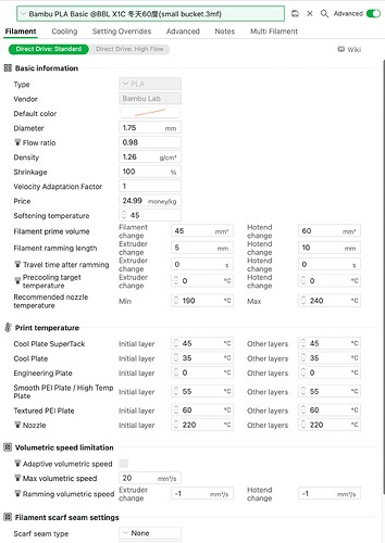

What type of generic filament? Exact brand, type and name. That models profile is specifically for PLA Basic. If you did not change the profile type, the max flow rate will be way too fast for most generic PLA and the cause of the problems. If you are using generic filament you need to change the filament profile to “Generic PLA”.

I took zoomed in picture at junction where it get normal. IMO issue is only when/where nozzle change the height to print the next layer above. After this height where corner get normal (see marked red rectangle) and consistent layer, right side overhang started bleeding as now nozzle change height at that location.
So at current rate its printing well just some weird issue while printer changing the height.
This is exact filament profile I used:
As I mentioned earlier, you need to use the “Generic PLA” profile with any filament that is not Bambu, that should solve your problem. PLA Basic from bambu is made for high speed printing and has a very fast flow rate, most generic PLAs have a much lower max flow rate. Also any Generic specialty PLAs like matte, silk etc might have an even lower flow rate, thats why I was asking for the exact type… not just “PLA”, what kind of PLA.
Ok. You could be right let me try with changing to Generic PLA. I choose Basic PLA as brand I bought claimed this PLA for high speed.

Setting to generic PLA profile solved the issue. Thanks @maxim3D for your all the help :slightly_smiling_face:
