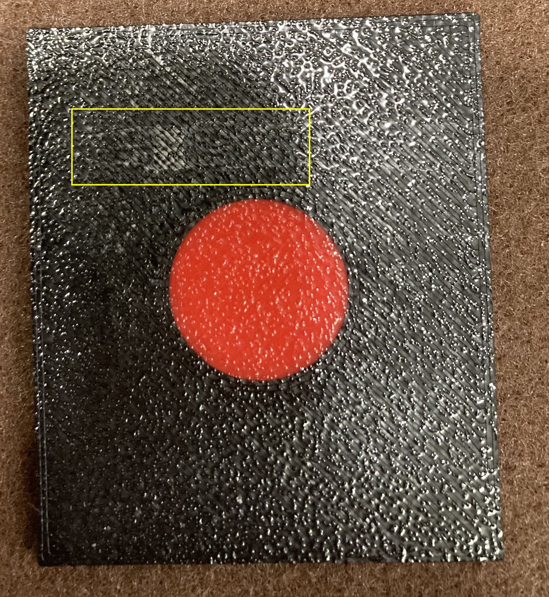

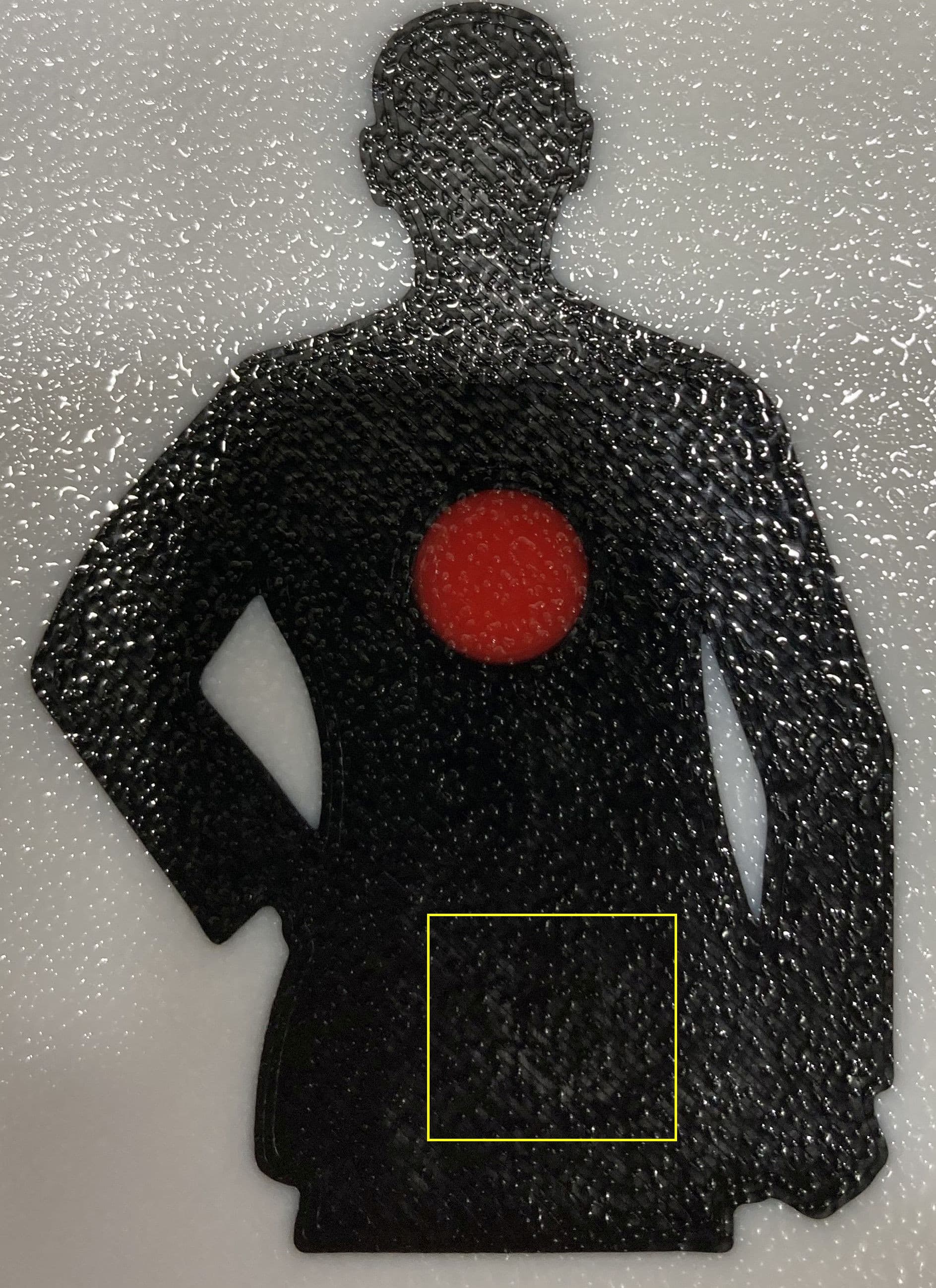

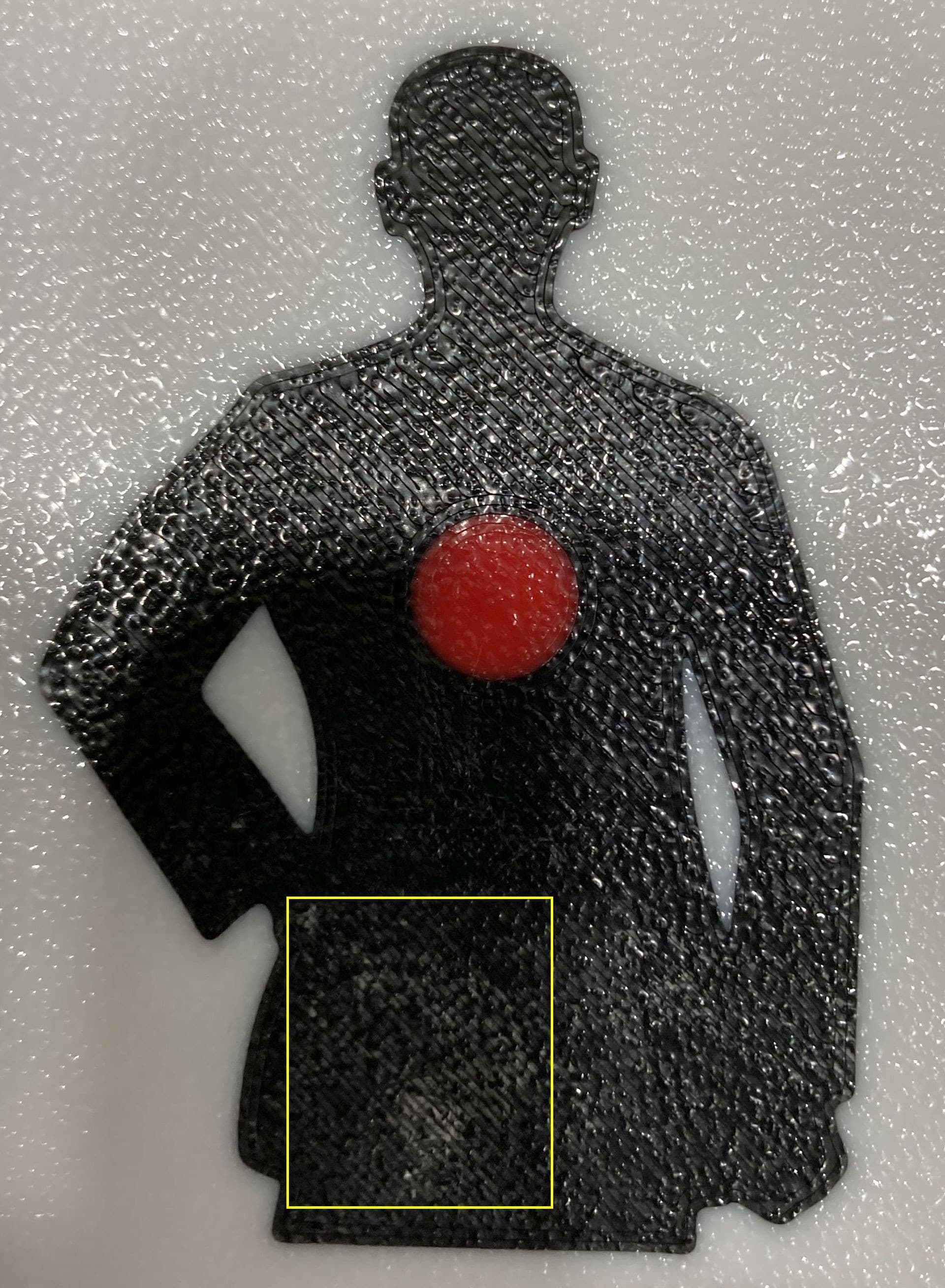

What is this mystery blemish? (photos)
In the first print, I was using a Sunlu black PETG matte. Notice the “cloudy” blemish. I tried again on another area of the build plate: better but still not clean. I let the AMS dryer run for twelve hours before printing the third sample. Still there. I’ve got an idea, but I want to hear what you guys have to say. Any responses will be appreciated. PS: The images don’t appear in order even though I gave them number tags.
They’re stress marks caused from shrinkage and or pulling the print from the bed plate. I use a heat gun and wave it over the marks to remove them. Don’t hold the heat in one place too long, just wave it back and forth enough till they disappear.
Thank you sir! Problem solved! I really appreciate it.
