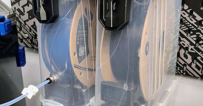

Small addition but I designed an inside nut for the pneumatic connector for the ceral box dryboxes: https://makerworld.com/en/models/25792#profileId-23751
For the lower roller assembly I’ve settled on this one which fits the bottom of the cereal container better than other’s I’ve tried: https://makerworld.com/en/models/191263#profileId-234808

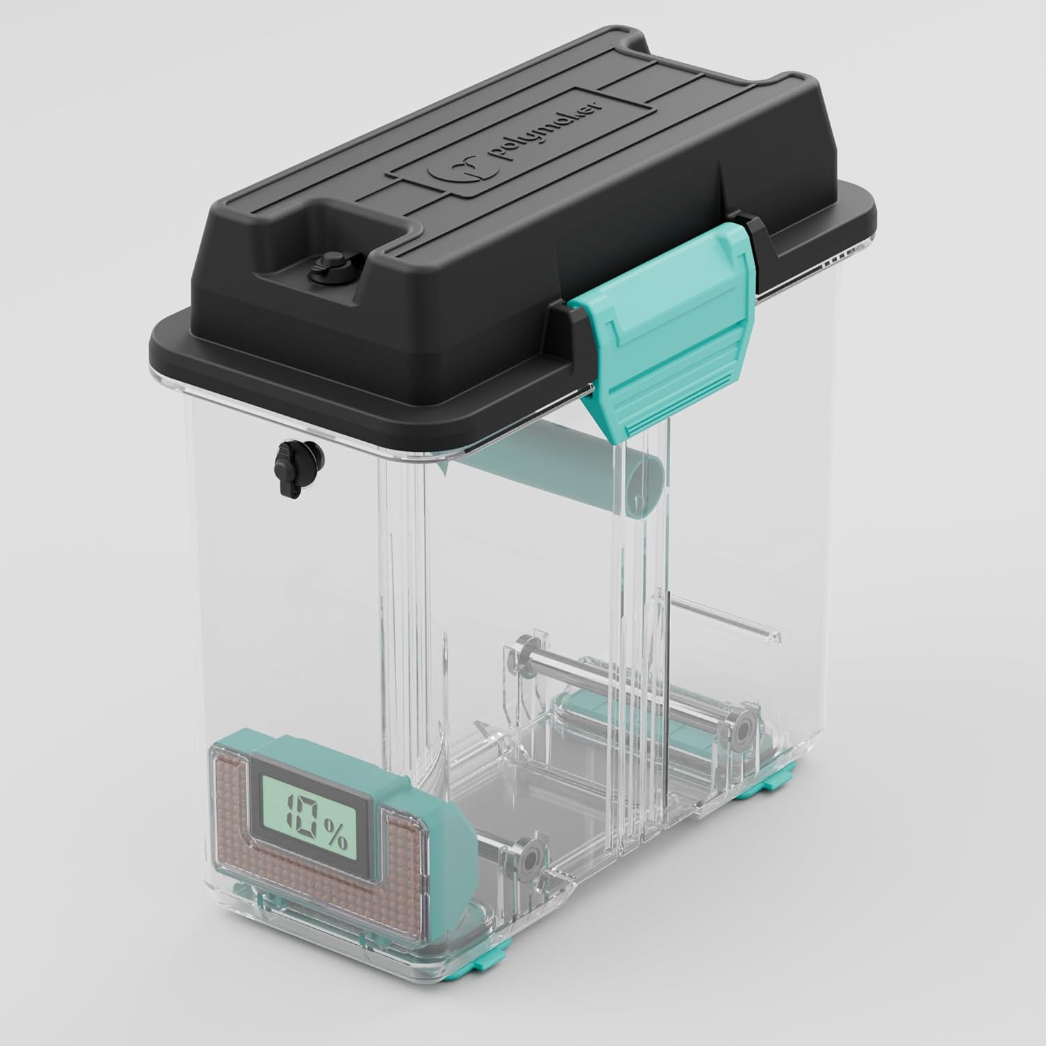

I just bought the Polymaker Polydryer Box. They’re pricey, but they work great with two output options—either from the side or the top. The sleeve that comes with it is quite large, but the good thing is that the Bambu one can slide right into it, so you end up with a connection that has almost zero humidity leakage.
i bought 22 of those, at 35 euros each you get my drift when i say they are pricey

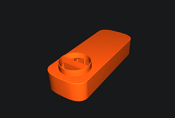

I’ve had the Polymaker PolyDryer for about two months, and it falls well short of expectations. Using the same methodology I applied in my Sunlu S2 vs. Creality Space Pi Bake-Off Review, I found the PolyDryer has only one real use in my setup: drying the desiccant inside my cereal box filament drybox, based on this design:
(The printable duct adapter integrates well.)
Here’s a breakdown of where the PolyDryer falls short:
  1. Insufficient drying temperature – It never exceeds 60°C in my tests, regardless of test point, which is inadequate for drying PETG in under 12 hours.
  2. Poor value – As a dry box, it’s wildly overpriced. My cereal box setup, including hygrometer and rollers, costs under $10 and outperforms it.
  3. High acrylic box cost – The clear acrylic case is admittedly well-made (and nearly $25 on its own), but the total package doesn’t justify its price given the underwhelming performance.
  4. Undersized desiccant tray – Holds less than 30g of desiccant, compared to 75–90g in the cereal box build.
So why did I buy it? It was on sale for $60 with free shipping. At that price, I saw it as a convenient way to regenerate desiccant inside my sealed cereal box system - without having to open or remove anything. For that very specific use, it’s fine. At full price, it’s a waste.
Here’s what the adapter looks like:

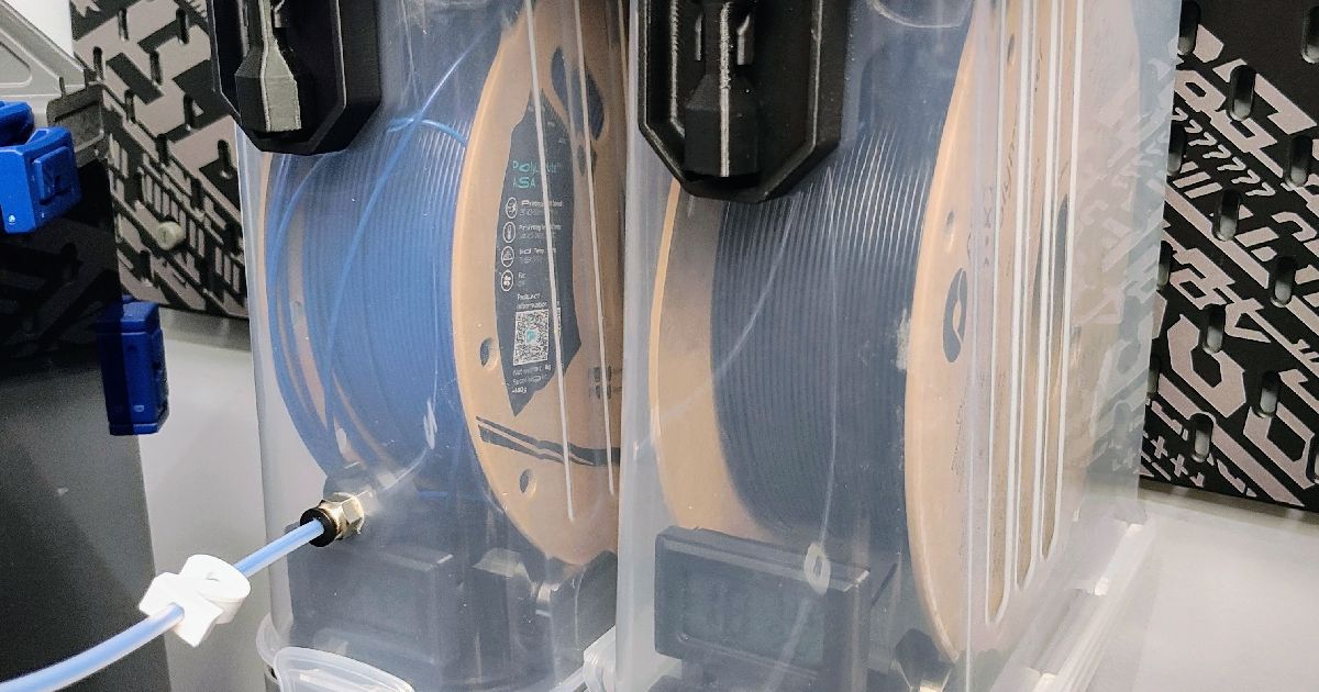

i don’t have the full dryer option with the heated element, i just use the box, i got 2 ams and one ams HT to dry
also for the desiccant part, i use bag of it in addition of the small container in the front
