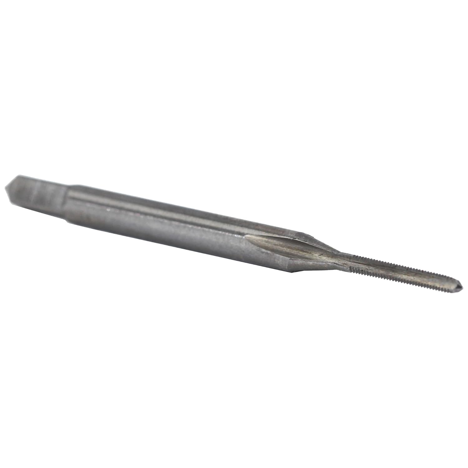

Did you know that if you go through the trouble of creating a set of filament profiles with calibrated X-Y hole adjustment, you can create a hole large enough for a screw and then finish the threads with a Tap and it will be nearly as strong as brass heated inserts. The trick? Just increase your wall thickness on print to ensure that you have at least as many walls surrounding the hole as the hole is wide.
Start off with a series of sample holes. I used ONSHAPE as my CAD tool but it is possible to do this right within the slicer using the negative part cylinder primitive albeit, far less accurate.
Once I had my test plates set up, I cloned them and marked them using the Text tool in the slicer in order to test the accuracy and vary the X-Y hole compensation.
Then I eyeball it and increase the number of wall loops so that the outer edges of each hole as enough wall thickness to allow my tap to bite into. This also will show me when I have my holes too close to the edge of a part.
Then I use a tap to create the thread and I have found that this is as strong as brass inserts without the hassle of heating up the solder iron.
This is the best style tap as it has a flat bottom and is perfect for plastic. BTW: It’s also the same thread that is used in 90% of the screws on a BL printer. So if you have this around and somehow can’t get a screw in, or if you’re adding a part to a previously unused factory hole, this will clean out the thread and make it perfect. It’s very handy item to keep in one’s tool kit.
BTW: This is also very forgiving method because if you make the hole too small, simply enlarge it with a small drill held be a Spindle vise, then tap it.
