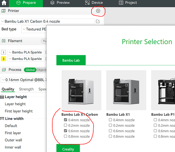

What needs to be done in the software when changing nozzle size?
I just recently got a 0.2 nozzle and after installing it I noticed there was no place for me to update the nozzle size. In either the X1-C or in bambu. When I go into the printer properties in bambu the nozzle size is greyed out at 0.4mm
Choose which models you have.
If you have the newest firmware, on the printer touch the Hex icon, then the maintenance tab. On the right is a dialog where you can enter the nozzle size and whether it’s hardened or stainless.

In newest firmware I believe you need to set it up on printer. Bars icon :point_right: Nozzle/Extruder :point_right: Nozzle Type (small pen icon). Then you can click Sync Printer Info in Bambu studio.
