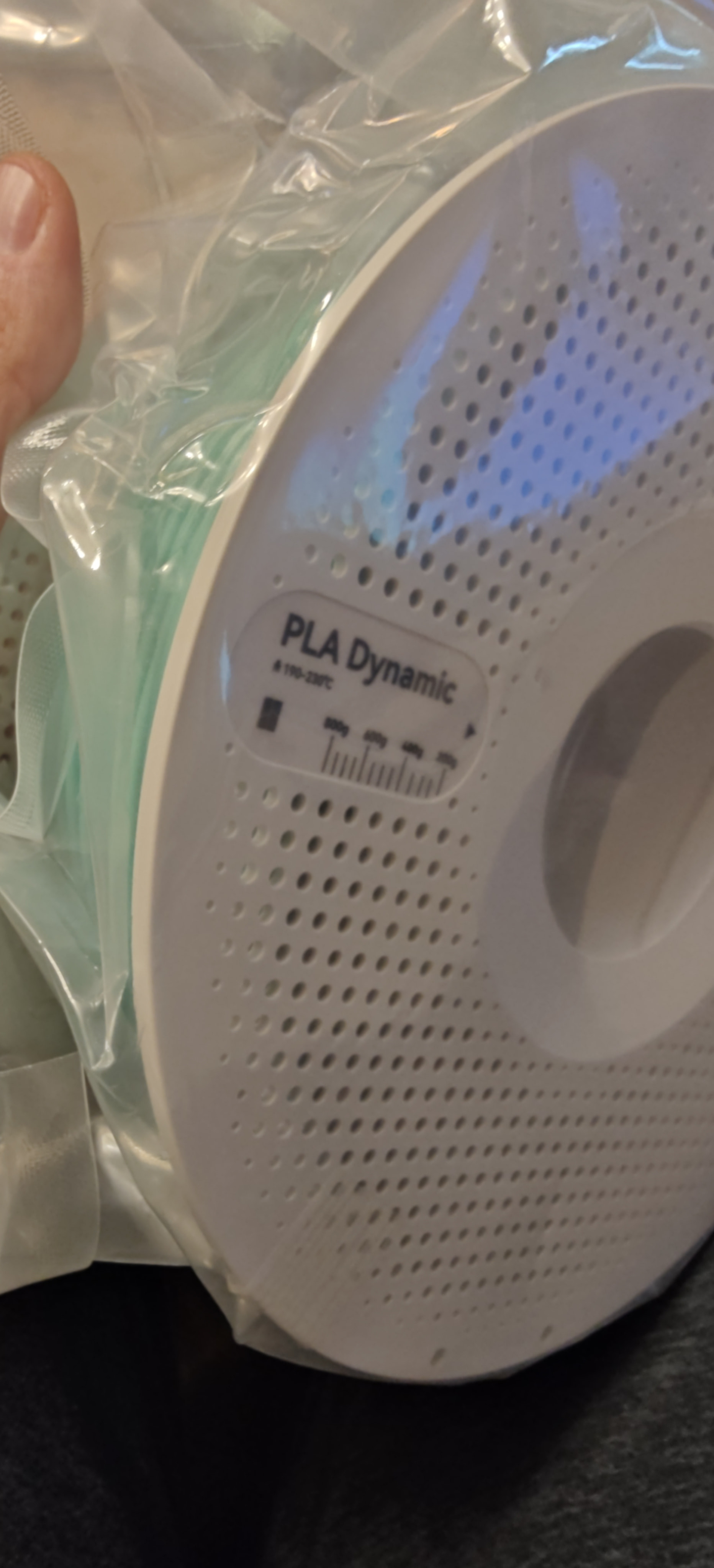

Exactly :). I have one roll of Dynamic which darkens when it is hit by UV light. I would also love to have a roll which lightens up when heated up.
