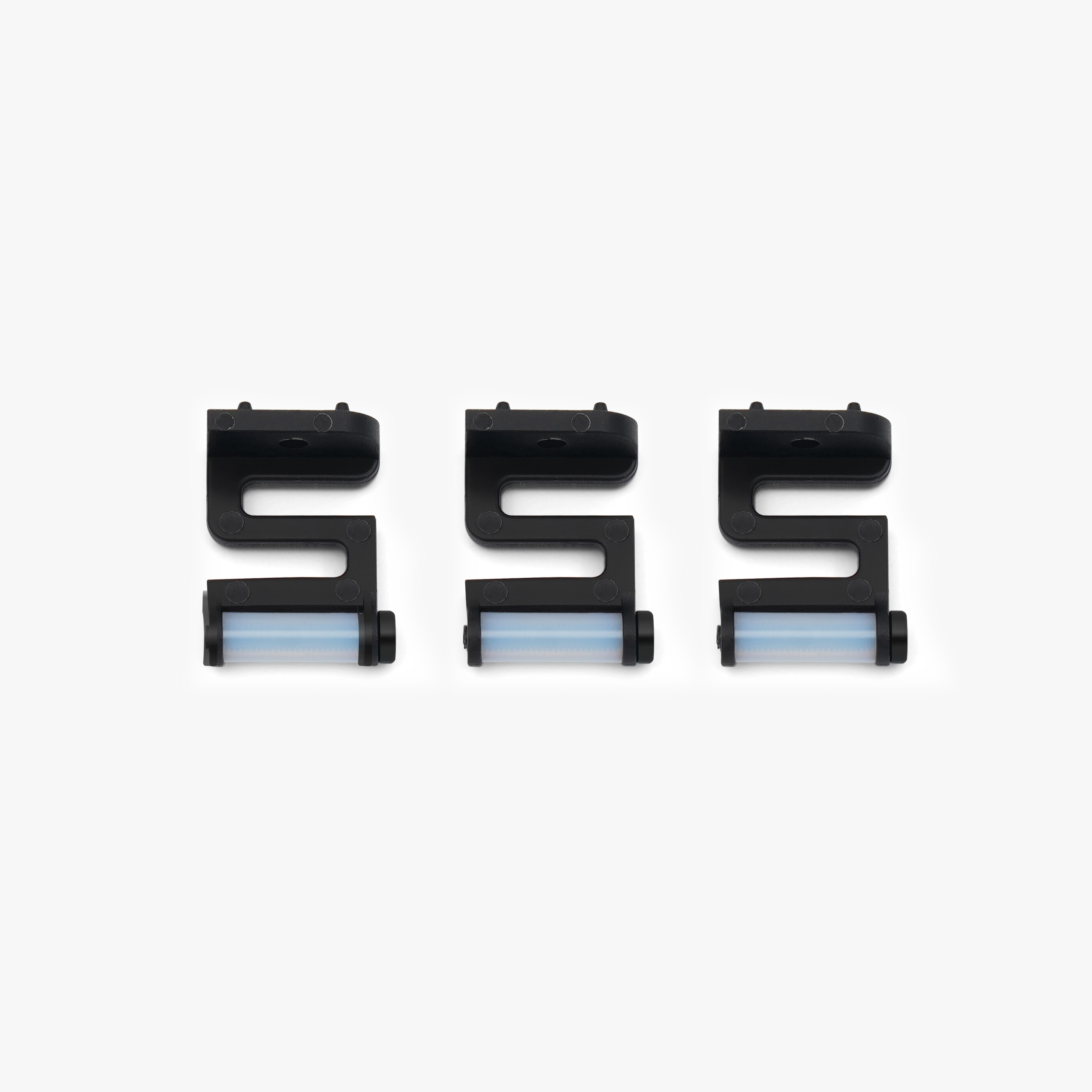

  1. Nozzle wipers. Again, it’s considered a consumable by Bambu and that you definitely want to buy from them. They come in packs of 3 and again, I’ve only replaced mine twice in the last 3,000 hours/2 years. It could be argued that you don’t need a replacement very often.
