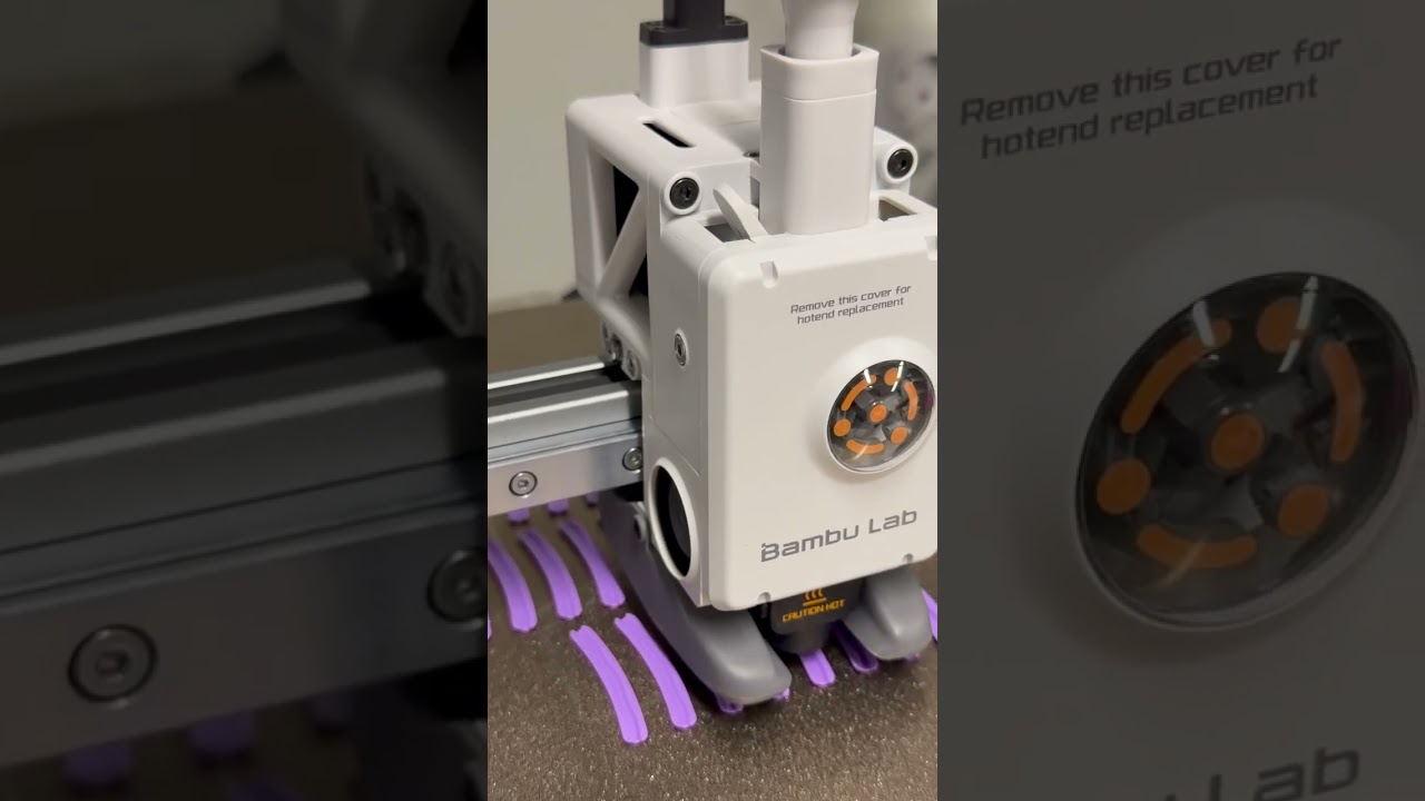

Can you record the sound and post the video so we can hear it?
No worries, I‘m 55, and I can‘t hear any weird noises on all my Bambulab printers. Seems I‘m a lucky guy. :partying_face:
Another guy (not you?) uploaded a video on Reddit reporting the same issue as you, and I‘m pretty sure his fan is broken.
That‘s mine:
My A2L has also the high pitched fan noise, much louder than my A1.
