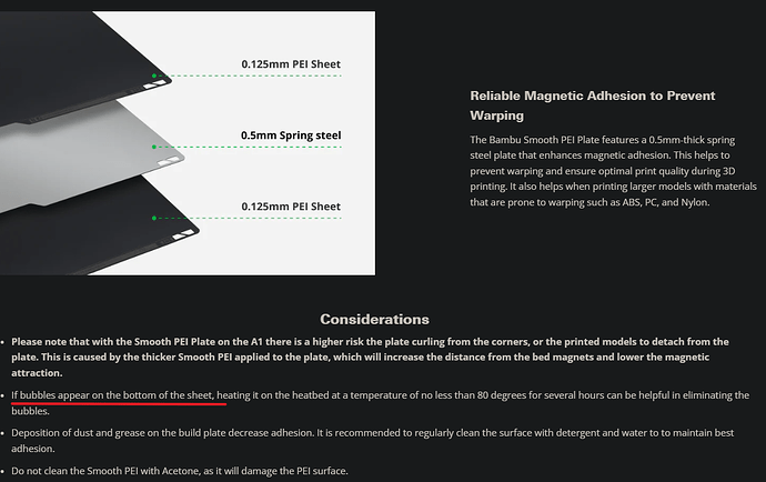

Smooth PEI is same as this Spare Sheet for Bambu High Temperature Plate (Smooth PEI) ? Can it be applied to textured PEI plate?
Textured PEI like the name suggests is not smooth so the sticker will only stick to the high points of the plate. It will certainly works though but isn’t it what you have on the other side of your engineering plate already?
I have the high temp plate which has this sticker on one side and an engineering plate on the other side. I print TPU on the engineering plate and I never dared printing it on the sticker side as I for sure would lift the sticker. The smooth PEI plate that bambu now sells is not a sticker but coated, I would be less concern with the new one that the one I have.
Based on the description, it sounds like it’s still sticker based not coated which is what I’m looking for.

The engineering plate has some kind of tough coating on it. In one of the other threads we even deduced what it likely was. Nonetheless, maybe you would get pretty much the same benefit by printing directly to spring steel. There are various vendors out there selling raw spring steel plates that are cut to exactly fit Bambu printers. Wham Bam is one of them. A search would doubtless turn up more. One advantage to that is that it would be pretty much indestructible. For instance, if you ever had a filament stick to it too hard, you could use an entire arsenal of solvents and/or blow torches to completely get rid of the stuck plastic and quickly return to “good as new” without in any way bothering the steel itself. It really would be good as new.

If you ever want to go naked buy the cheapest plate with a sticker you can find :wink:
Enjoy the patterns while it lasts, then peel the sticker off and get you nice steel plate :wink:
