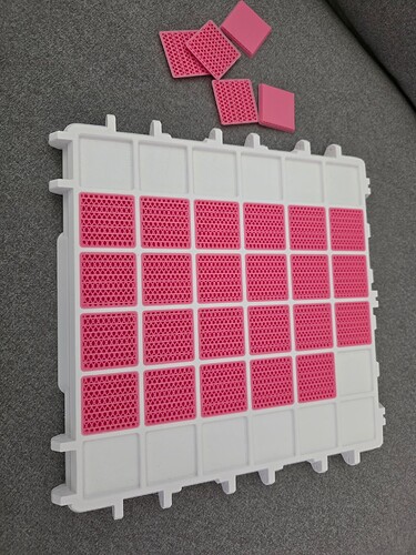

By the way, the print came out fine. I was using pink PLA to provide throwaway printing support for the bottom of the white PETG rugged gridfinity organizer box. Just need to pop the rest of them out now. A good fit for the H2D’s two nozzle capability.
