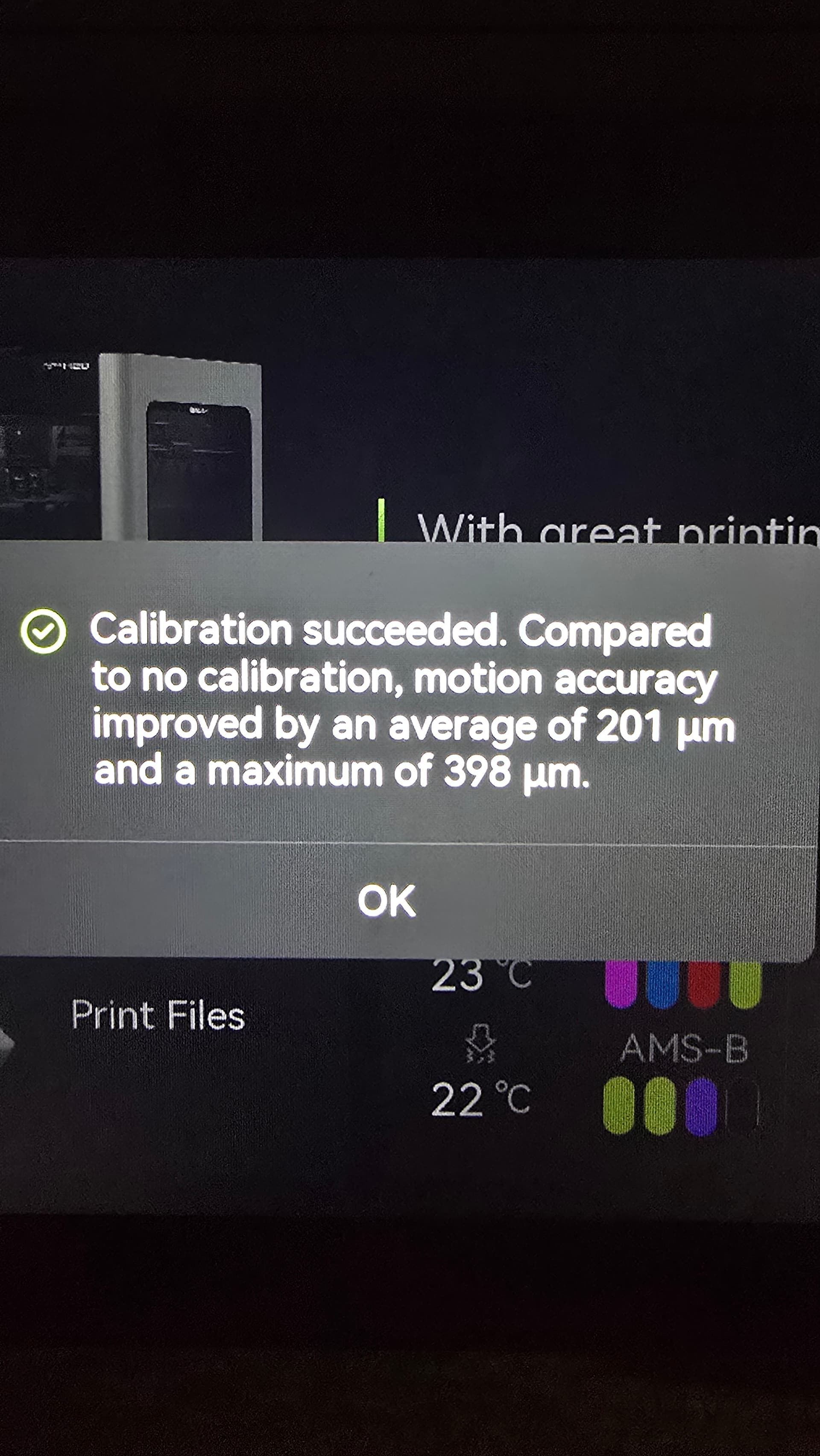

They claim one calibration with the encoder should last a few weeks
After a few calibrations with the encoder plate I got yesterday, my accuracy actually got a little worse. My average was in the 230 range and the max deviation was in the 430 range. Because it basically repeats the value on subsequent runs, I’m assuming it is simply running the test from a raw machine baseline. So, I’d assume each time its run, it clears the previous adjustment and starts from scratch.
I ran tests on 200mm squares, a few small holes, and a slot. My baseline was really good on the large squares, nearly no significant differences, the small holes got a touch worse (approximately 0.07mm worse), and the slots were about the same (approximately 0.05mm worse, but within a reasonable deviation).
Personally, I was hoping it would improve the hole accuracy, but that is still relatively unchanged (my holes are consistently 0.3mm undersized, and after, looked to vary up to 0.30mm - 0.37mm). Overall they seemed to get a little worse, but could be within the normal deviation from hole to hole. So… overall, I don’t believe it makes a difference on that.
All and all, in the back to back prints of the same file (toggling the adjustments on and off), I’m finding I’ve lost about a 0.1mm or so in accuracy. So…not a serious problem, but I think Bambu still has some work to do, especially if you are going to charge $100+ for it.

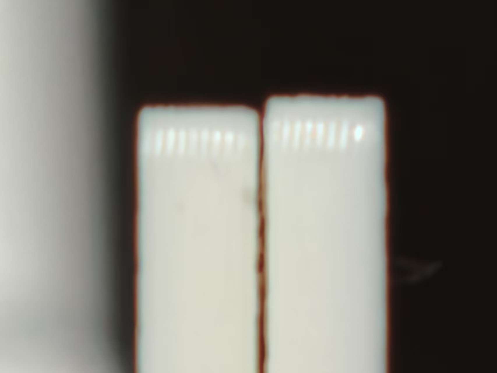

A 15cm part before and after calibration
I had a test calibration print that spanned 250mm and the difference before and after was a whopping 0.04mm (249.95 vs 249.91 for the calibrated print). I would actually call that expected variance, from print to print. Again IMO, not worth the cost if you have a good printing printer.
@hotellonely I am curious though, would you call your printer bad for holding spec prior to the calibration?
No I think the filament shrinkage is doing more harm in any sort of fdm. Correcting the motion system is just giving you more peace of mind and can focus more on the shrinkage itself.
