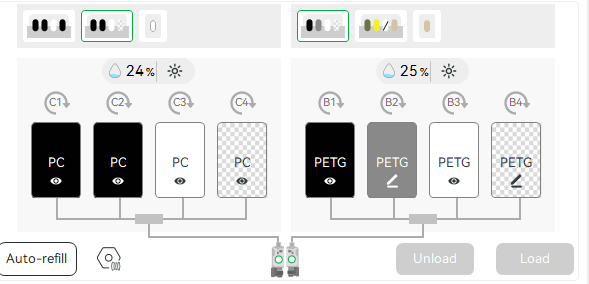

What are people using as a cut-off on replacing desiccant/drying filaments aside from when the print quality deteriorates? I’m respectful of not drying filament too frequently but I’m seeing moisture levels increase in my AMS2’s and wondering about cut-off/tradeoffs. Advice please

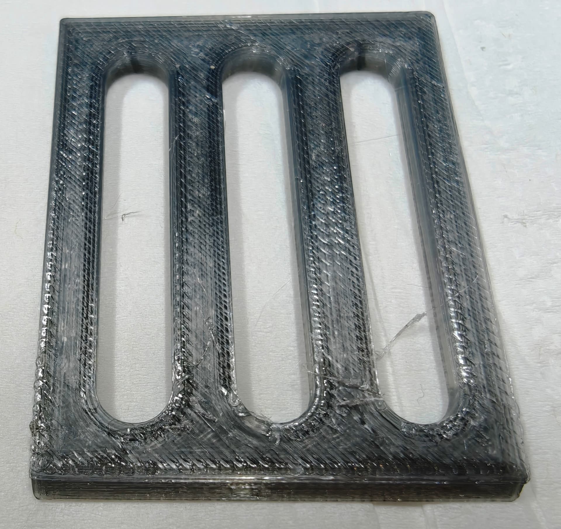

Thanks EnoTheThracian. Maybe not at 11%, but if you were slack like me and saw it get to 25%, would you just replace the dessicant or also dry the filaments; given the PC filament in C2 just produced this part? (It’s approx. 40x50mm)

I would probably try do re-dry, just to rule that out as a root cause, re-calibrate Flow and Flow Dynamics and try a further print at reduced velocity to see if the failures improve. Maybe also with concentric surfaces to get a smoother nozzle movement and less pull-out.
Good advice. Sometimes, I get too close to it all and need a fresh perspective (like this). Thank you.
