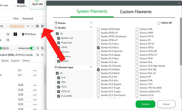

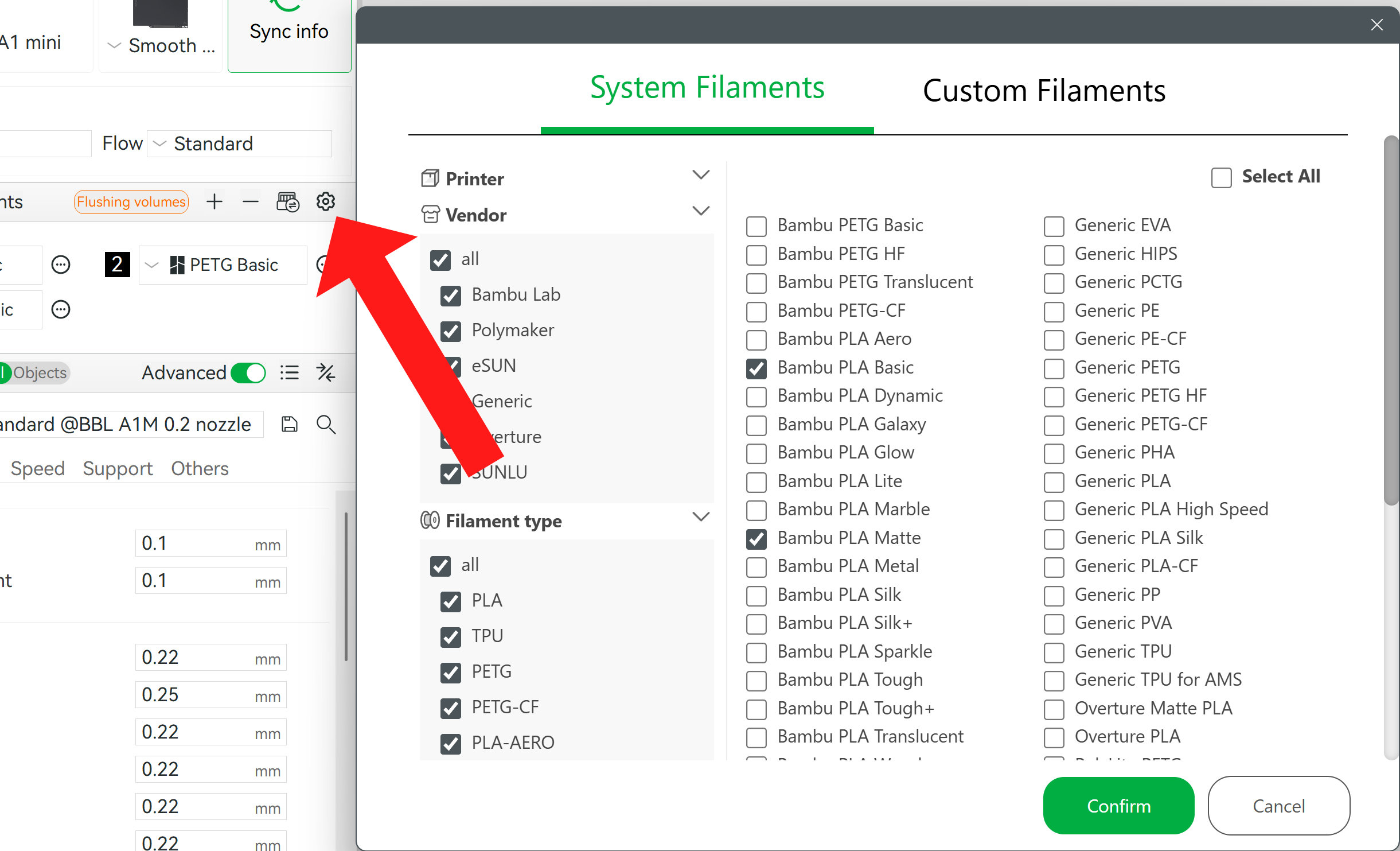

I have been using BBL studio for a week now, and can’t figure out where i can find other filament profiles than Bambu and Generic.
It looks as if others have profiles for a bunch of brands, am i missing something?
Latest studio for Mac piloting a p2S..
Thank you for the reply. My problem is that In that vendor menu there is only Bambulab and Generic..
I think the “issue” is your printer, so to speak. Each filament profile seems linked to a specific printer, and only the filaments which have a profile for your selected printer(s) will show up in that list. Which will exclude the whole vendor if there are no filaments for them.
You can verify this by looking in your Studio’s configuration folder (Help → Show Configuration Folder), look in the system/BBL/filament directory. There are lots of profiles in there for various printers and nozzle sizes, but for P2S I’m only seeing BL and Generic types.
I had to look because in the screenshot @ RetroSharky posted there’s SUNLU and mine doesn’t show that vendor at all… but it’s because there are no SUNLU profiles for my selected printers (H2 series).

Thank you very much for the research, this looks to be right. The profiles being linked to the printer each printer doesn’t have all the profiles.
