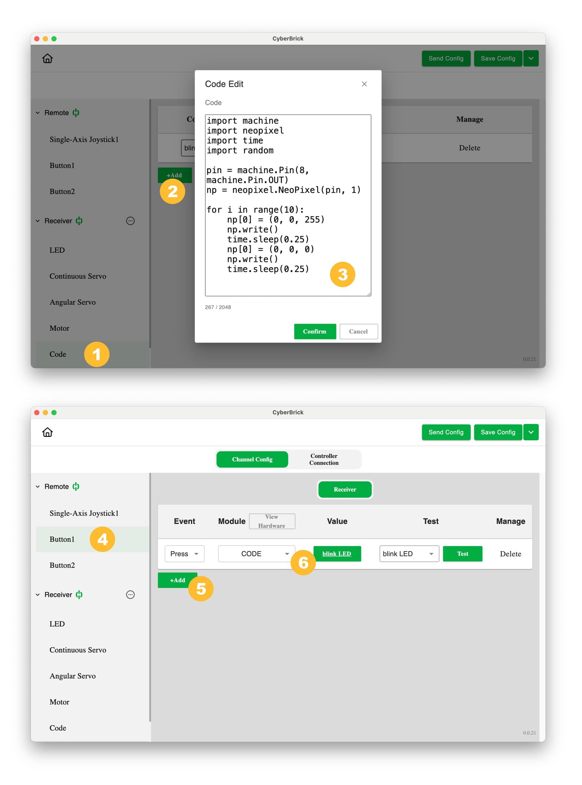

For many actions, using the GUI will be the most straightforward approach. If you’d like to add some custom code snippets, you can do so following this process:
  1. In the CyberBrick desktop app, after pairing your devices, select “Code” under your receiver.
  2. Click “Add” to add a new code snipped.
  3. Write and save your code. If you use an external editor, there’s an issue on some platforms with pasting code into this field. If that happens, you may be able to drag the text and drop it into this field.
  4. Under the Receiver, select the component that will be used to trigger your code snippet.
  5. Click “Add”’ to add an event.
  6. Change the Module to “Code” and the change the value to your code snippet.
After doing this, you can save and send your config to test on the device or click the “Test” button next to the event.
This example just makes the onboard LED blink.
