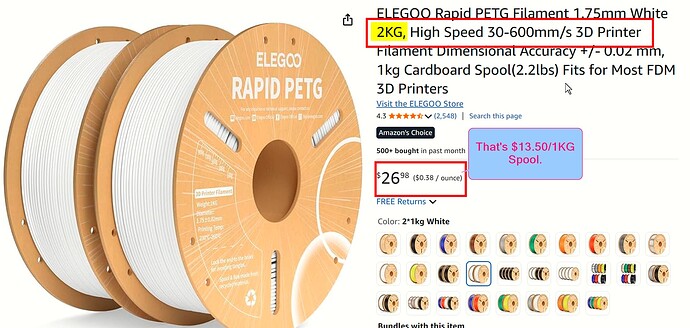

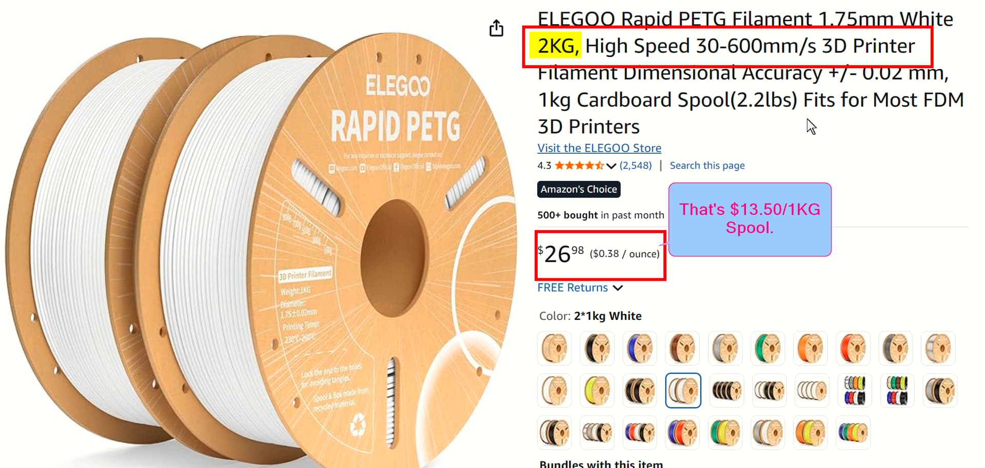

Sorry but how can you say Bambu “charges a premium” when the PETG filament link you provided here is currently $26.99 a spool?!? I’ll wait for Bambu to restock and buy in bulk at $14-$16 per refill. Never have had an issue with Bambu customer service.
How can I say that? Here, let me help you out :grin::

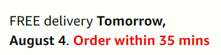

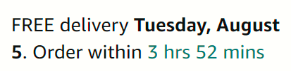

On customer service: Amazon has rarely been stocked out, and my spools arrive same day (if ordered before 8AM) or, worst case, within 1-2 days. Even ordering late Sunday still lands by Tuesday.
White PETG:

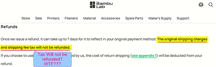

At Bambu? If there’s a problem, it takes weeks to resolve. Amazon? Three clicks, 128 characters, and my return is done. Refund hits within 2 hours of the barcode scan - even on a partial spool.

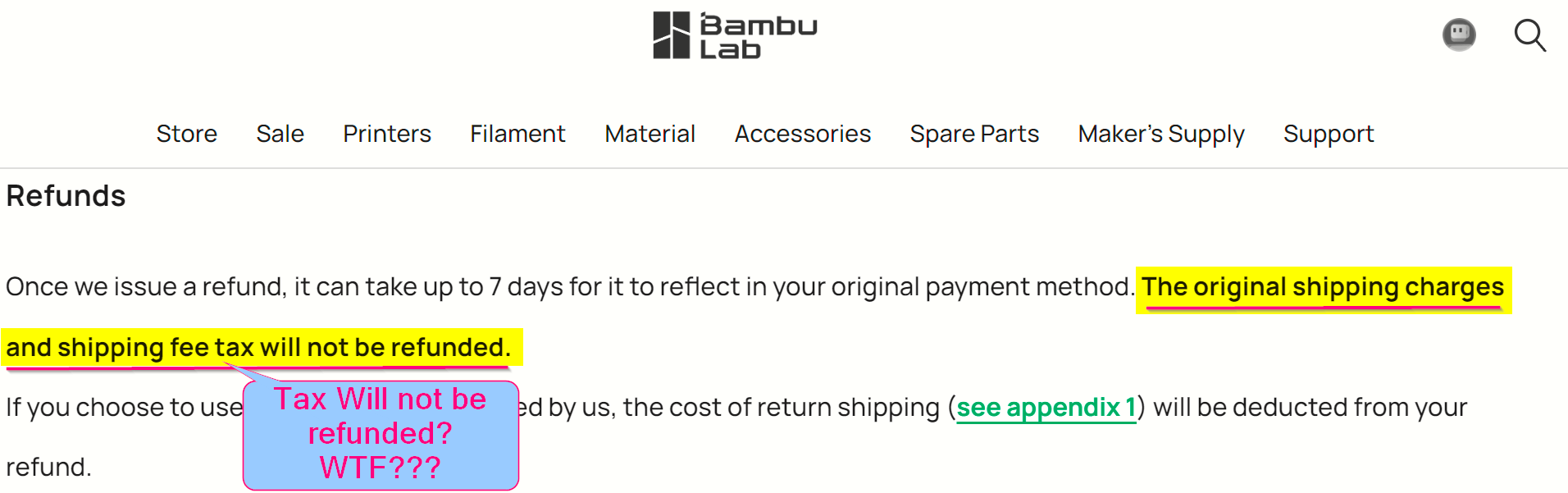

Can Bambu Lab say that? Oh, and Amazon covers return shipping. Here’s what Bambu Lab has to say:
It costs more to ship 1KG back than the item itself, which effectively means “no returns.” They’re not the first company to refuse shipping reimbursements, but Sales Tax??? Keeping tax that should be refunded adds friction and erodes trust. Refunds are required by law to include sales tax, and this forum is full of posts calling it out. My experience? Poor but not catastrophic. I only buy what I must - like printer parts - and on the two occasions I really needed help, I got stonewalled.
Still think their customer service is great?
