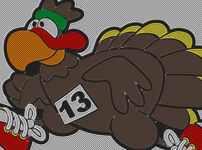

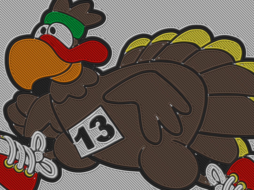

I’ve often had to go to ChatGPT or Google’s search AI when I need help. The Facebook groups are ridiculous and just people saying the same lines to every post or making fun of them. Where are you supposed to get help with prints? I’ve been printing for over a year and I have a P2S and H2C. I love designing in Fusion and then printing seeing my work come to life. My latest project I’m getting to the deadline and I can’t get it right. I’ve tried all kinds of different settings in Bambu and .4 and .2 nozzles. I just can’t get it right. I’ve tried Arachne, different line widths, different wall widths, different order of walls, only one wall on top surfaces and not, more top layers, thicker top shell thickness, beam interlocking, 1 file combined, and 1 split into parts, etc. If you can think of it, I’ve tried it. I don’t know if it’s just not possible to get this printed nice, or if it’s some setting I’m not getting right or with the right combination. The 0.2 does get it better, but still has gaps and the time increase was way up there. In the picture all the white spots are gaps where the top color tool paths aren’t covering the white underneath, not seams just FYI.
