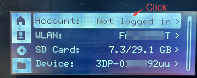

In wiki says that pin should be in account page. It is not in there. I’ve tried to log out but now I can only see QR code.

The wiki says:
The firmware version for P1 series printers starts from version 01.06.00.00, while the firmware version for A1 series printer starts from version 01.03.00.00. These versions now support PIN code binding of printers in Bambu Studio. This means that there is no longer a requirement for the printer and Bambu Studio to be connected to the same local network during the binding process. Please note that future firmware updates will also enable the X1 series to support this functionality.

On the new screens, I can’t find any mention of a PIN, Access code or anything else. There is no “Settings > Account >” menu any more (there used to be).

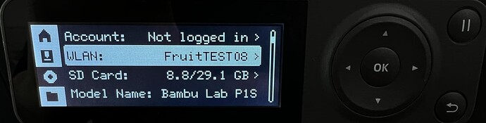

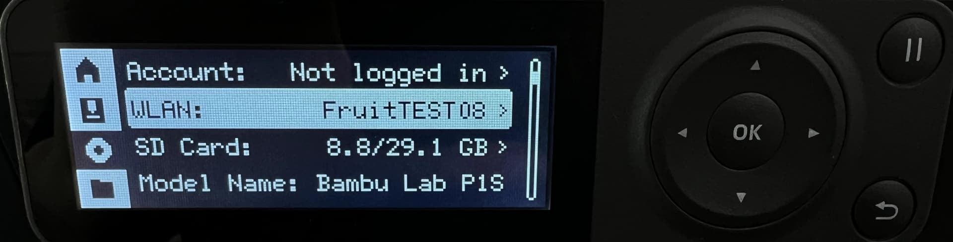

If it’s like the H2D menu you click on LAN Mode in settings, you don’t turn it on but you then have IP adress and access code in plain view
I believe this is for a P1S but the access cide is located in the WLAN settings.
Not sure how this maybe impacted by different versions of FW.

I have a P1S running on older firmware and in LAN Only mode.
I also cannot go any deeper on the Account menu than the top level.
