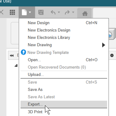

I think you’re saying I cannot load a .step file from Fusion. Would I have to use a different CAD program? Or can Fusion files be converted to .step files. Thank you for your time.
Fusion can export Step files and I would suggest this format when dealing with Bambu studio or transfering to any other cad system.
What Jon said. Studio can import both step and stl. I just did a job for a guy who provided both - step and stl - and step was noticeably smoother with no visible facets to curved surfaces. And the prints showed that too.
On the other hand, in Fusion you can adjust the “refinement” in the exported stl file and that also can really reduce the appearance of facets and steps to curves by running up the number of triangles used to describe the part.
Not sure which message you are responding to , but I ALWAYS export my designs from Fusion as .step files. There is no need for another program to convert the design.
From the Fusion file menu, select “Export…”
Then use the “Type” dropdown to select STEP files:
