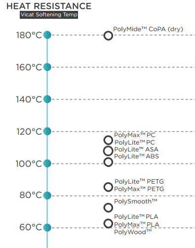

The most heat- resistant Bambu filament is PC, at 107°C. ASA is next at 100°C. Bambu does not offer a nylon filament, but nylon is probably the the best choice.
There are many manufacturers of nylon, but here’s a chart from Polymaker:

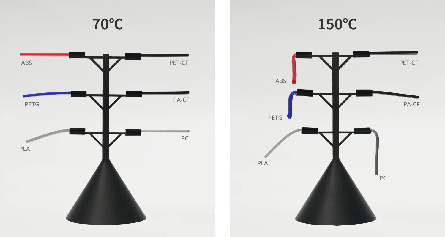

So looking further it seems PET-CF might be even better if your printer can print it.
From the PET-CF page, https://eu.store.bambulab.com/products/pet-cf
