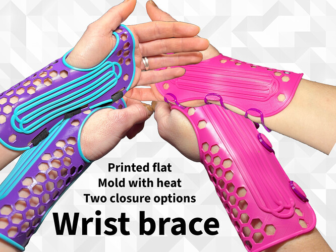

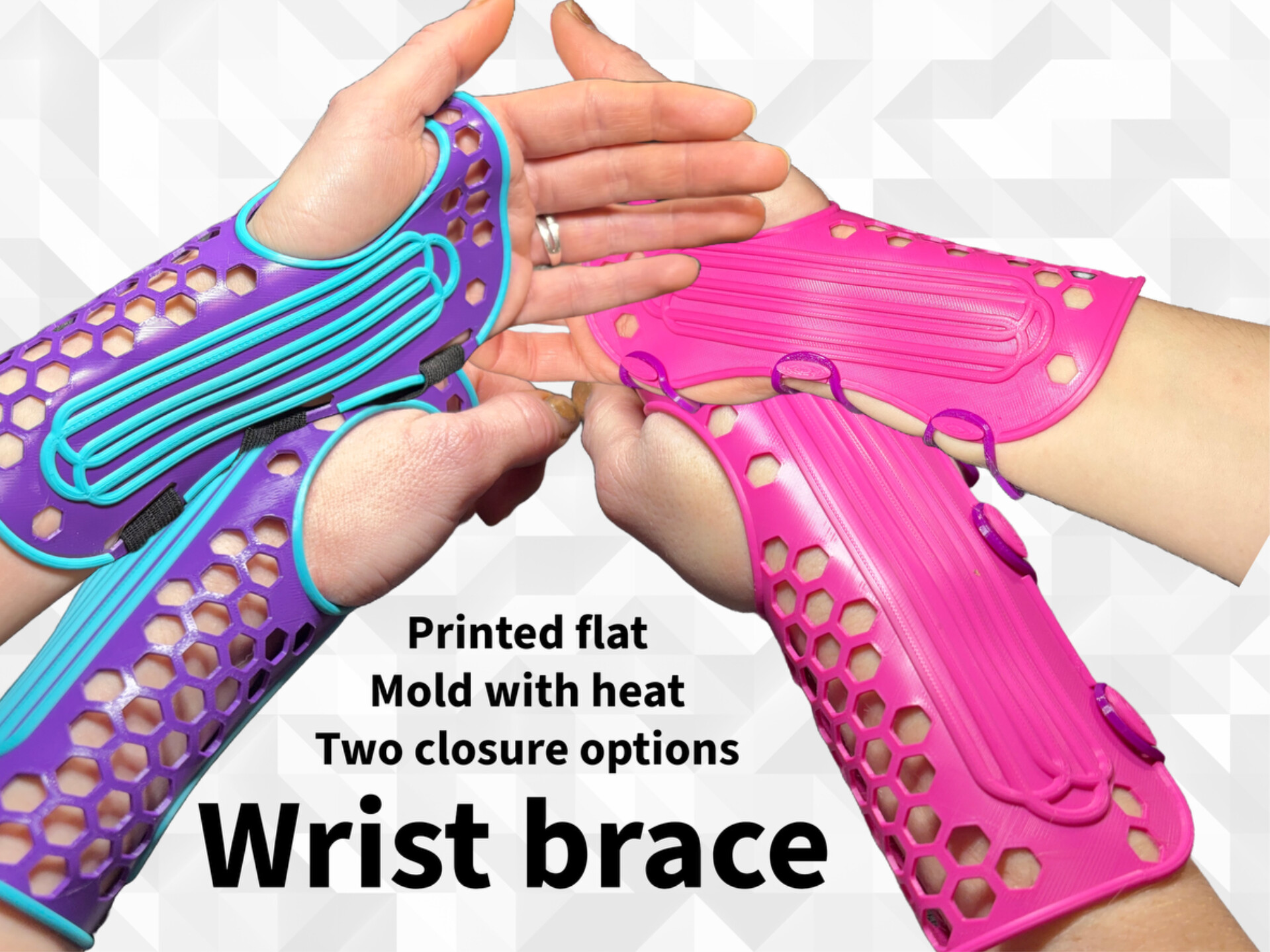

I’m thinking @familieKP would be knowledgeable about this. Her models are PLA and PLA with TPU straps.
I think PLA is safe for the skin because it is biodegradable and is made of cornstarch or sugarcane, which kind of also makes it food safe.

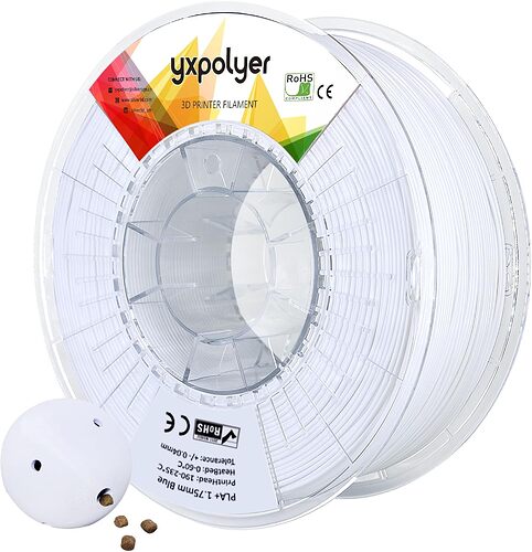

I’m going for this because I can get it delivered to me TODAY:

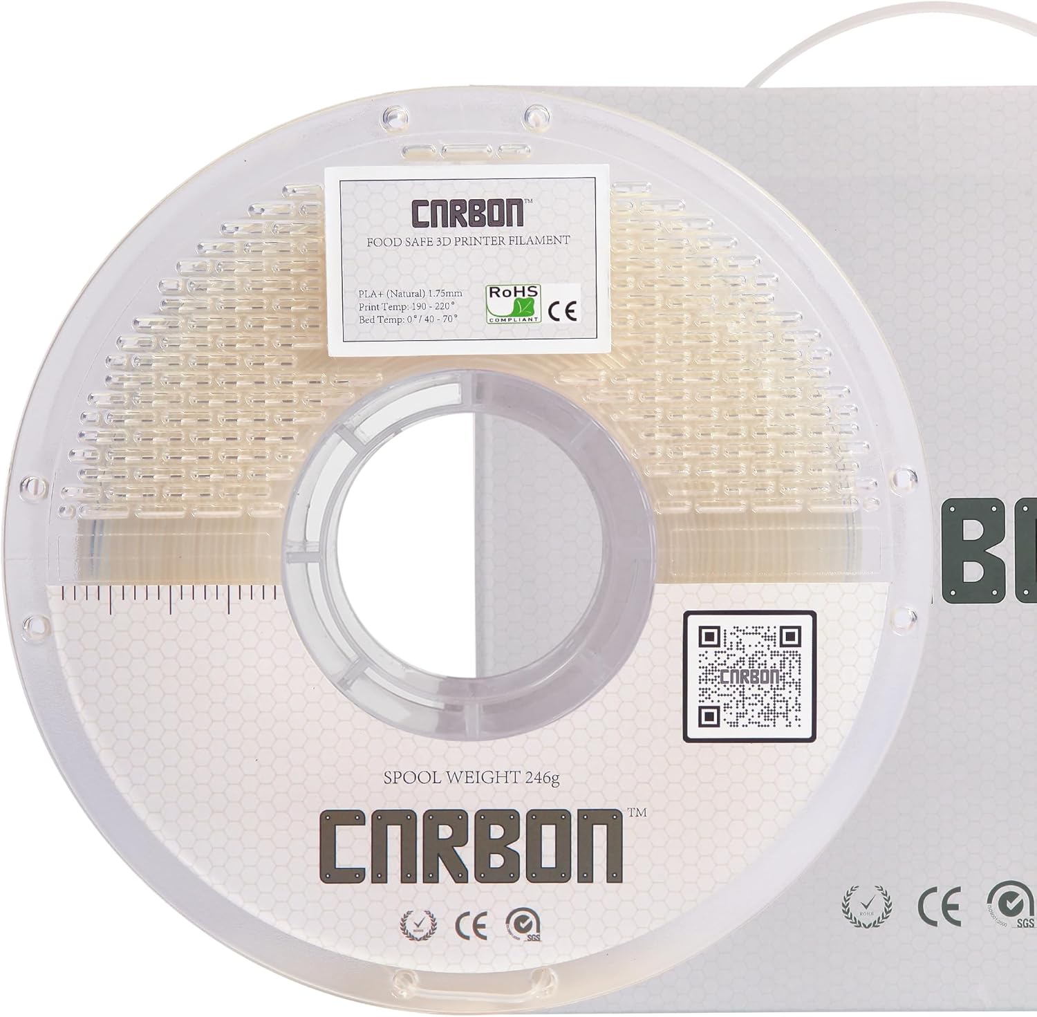

and this one is far less expensive, available TOMORROW:
Please keep in midn the way how your FDM printer is working. You are printing layers on layers. Between these layers there are micro gaps - the perfect home for all kind of germs. That’s why FDM prints without after-print-finishing can’t be food safe, independent of the used filament.
In addition most companies will never tell you the recipe of their filament, so you won’t know, what is in there. Just think about the coloring…
All in all it is a personal decision. I used for example PETG for kitchen tools and put them into the dishwasher. But I would never used them for storing food itself.

I’m thinking more like maybe this:
would be closer to what I’m looking for. That is, assuming the certifications can be trusted as real.
