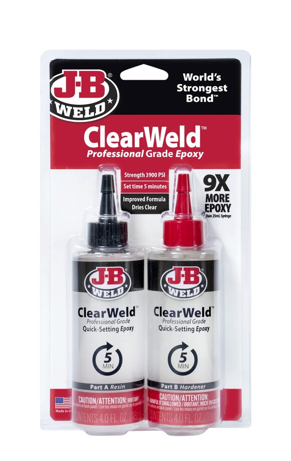

Standard 1:1 AB mix
~5-10 mins kick time, 1hr firm, 24hrs rock solid
“Honey” consistency when working with it, flows and coats nice
Dries crystal clear - can look amazing and glassy if you try not to stir too many bubbles in
Sticks to PLA
Isopropyl cleans up unkicked/spills
While it is stored before use, keep the “Part A” away from UV light - UV will cloud the liquid resin and it will dry up a little cloudy too
Can get it at hardware stores, not just online only
I suppose roughing up the PLA probably helps give it sone tooth to key into.
