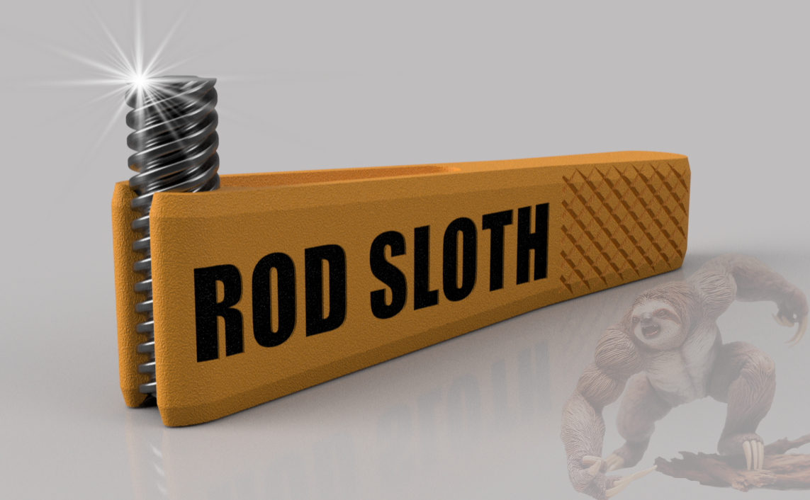

I like using the “Rod Sloth” for cleaning the leadscrews:
and I can confirm that even cloths which are self-proclaimed to be “lint free” break down while using it, leaving lint and threads and dust behind, which then needs to be removed. At last for the Rod Sloth, cotton (whether woven or unwoven) seems problematic.

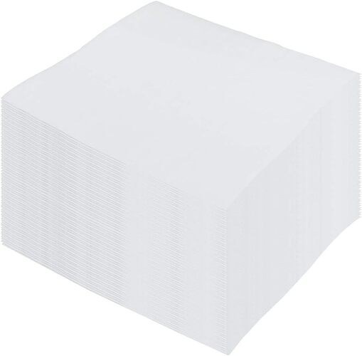

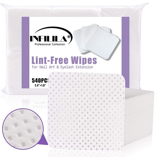

Therefore, I am thinking of trying one or the other (or both) of:
or
to avoid that outcome. I should be receiving those products tomorrow. If anyone is interested, I’ll let you know whether either one works any better.

I have been using paper towel, but I just purchased the lint free wipes, sounds like a good idea.
