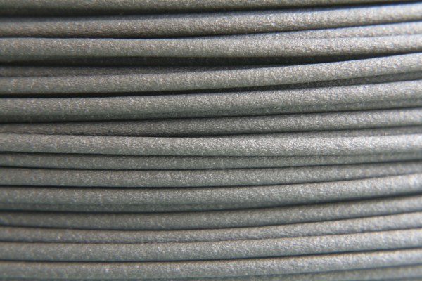

PETG can melt in hot cars, metal sheds etc.

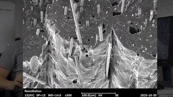

Fibre-reinforced filaments (like PETG-CF) should be handled with gloves which can make them annoying to use for tools. Small particles of the fibre get into skin etc.
Hence I would use ASA.
However, the dimensional accuracy of fibre reinforced filaments is better (they shrink less) but this can be overcome with print calibration or just scaling and reprinting.
Thanks for the quick response. I know that PETG in cars can at time be problematic but that’s really not a concern for me. However, I didn’t know that fibres might separate from the printed item and that most certainly is an issue for me, as I normally only wear gloves when welding and grinding, never for woodwork. Thanks for that.
