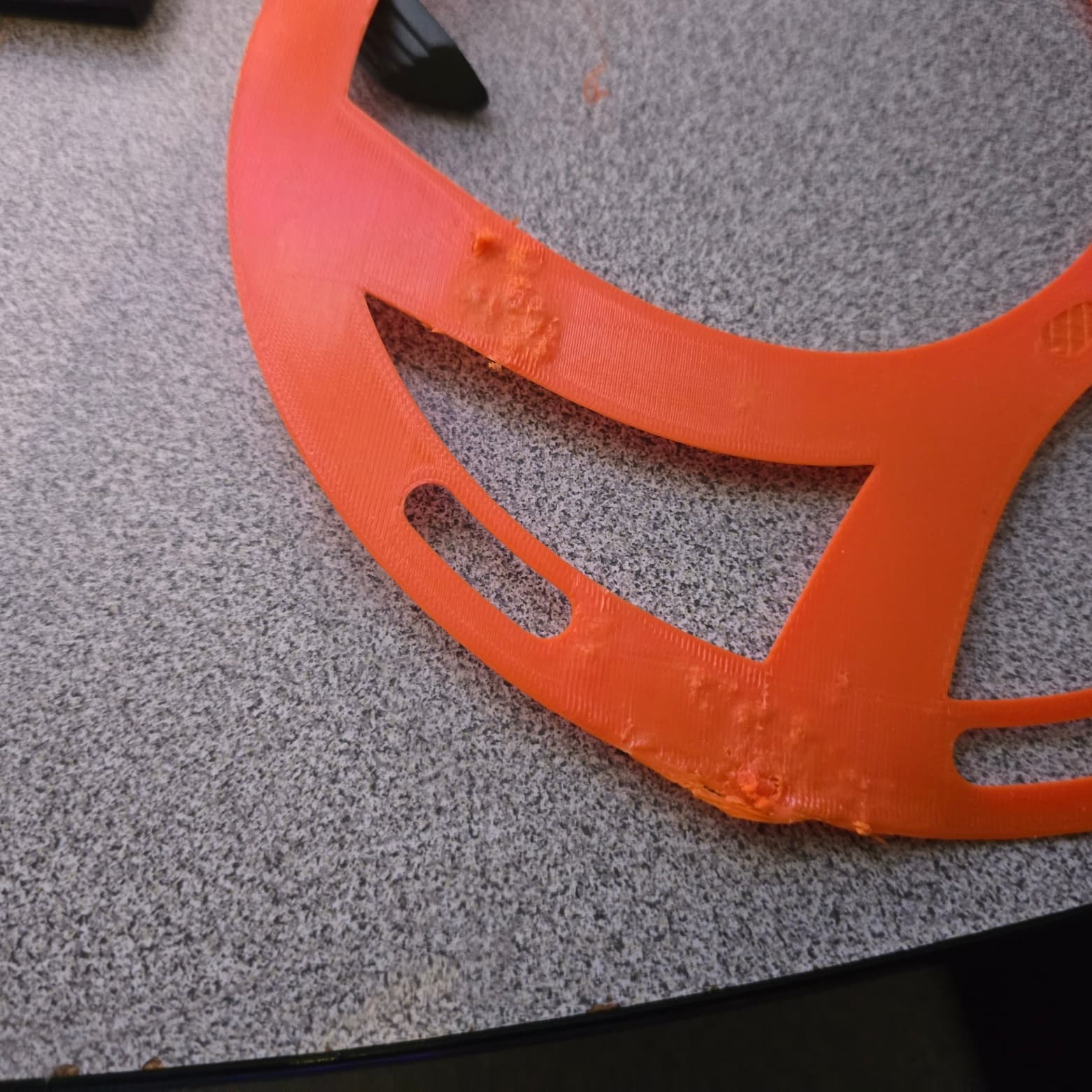

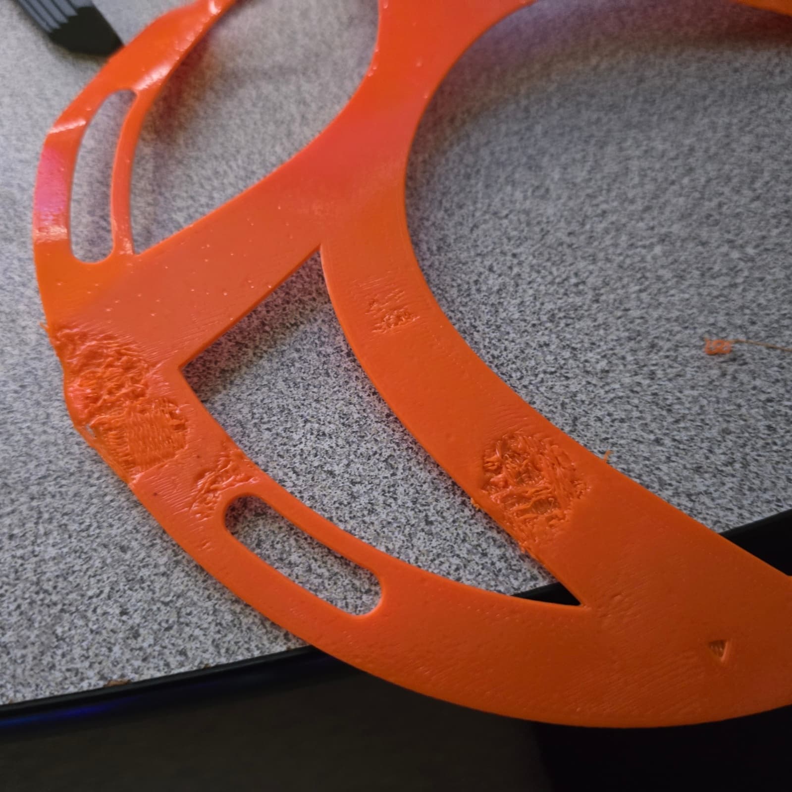

Hi, for some reason, when i print PETG i often get this problem here and i keep tweaking certain settings but i dont know how to fix is. Here are some pictures of each side of the print

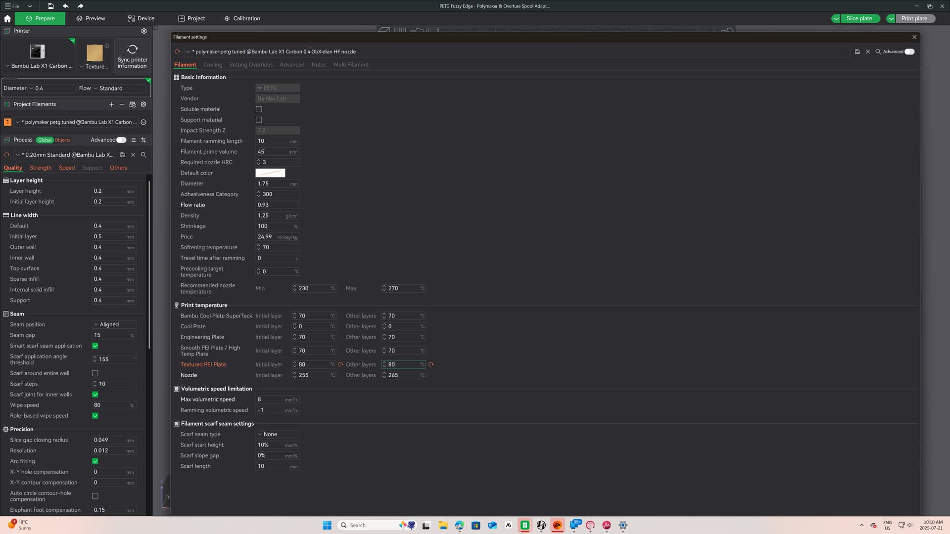

Im using a bambulab X1C. I’m also using a E3d high flow nozzle 0.4mm but im not sure its tuned properly and this is using polymaker PETG. Here are also a picture of my settings

Tbh, it does look like fingerprints on the build plate…

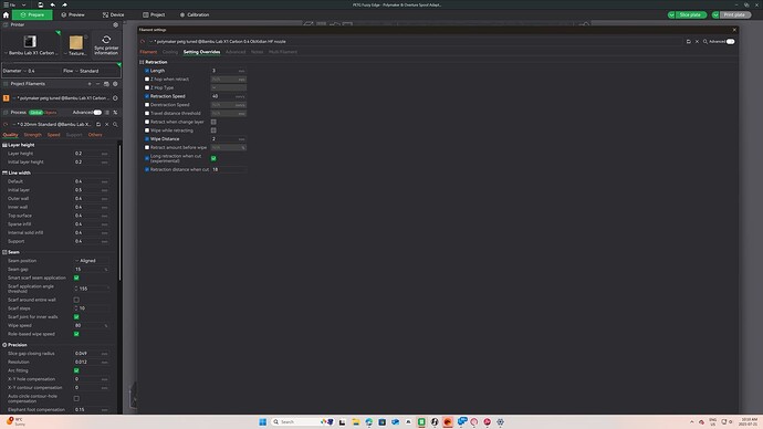

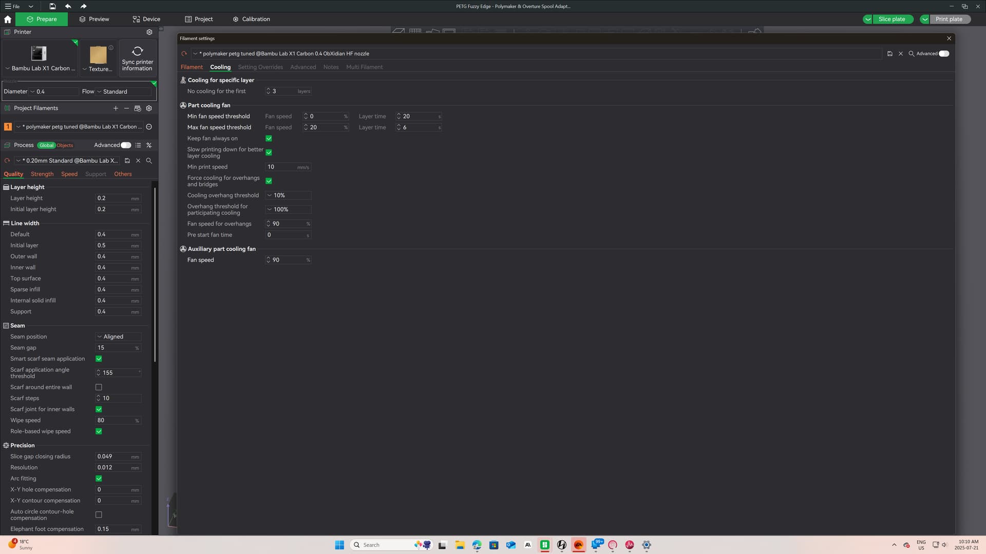

Wash the plate real good and set the aux fan to 0%. I would also put the retraction back to default. 3mm is crazy for a direct drive. That 0.93 flow rate is also kind of suspect. I don’t think I’ve ever had to set a filament that low.
my plate is clean and those settings i found on the polymaker website. Ill change it to try thanks
