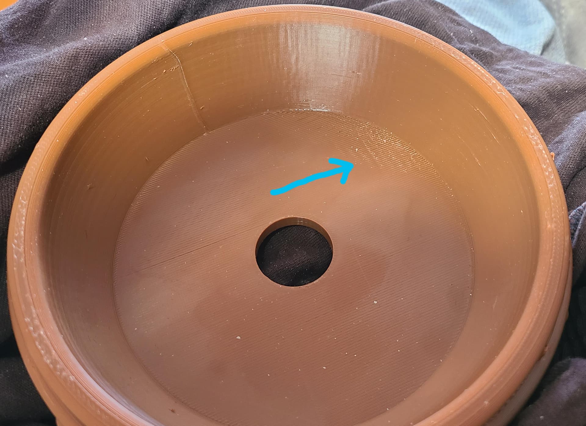

Anyone know What caused the ripple-texture on the pot as shown? Didnât happen with 2 other prints. Is it a fluke and I can re-print and hope it is not present?
Thanks.
Those waves are generally caused when a part warps/loses build plate adhesion in that area.
Cleaning your build plate will normally solve this.
