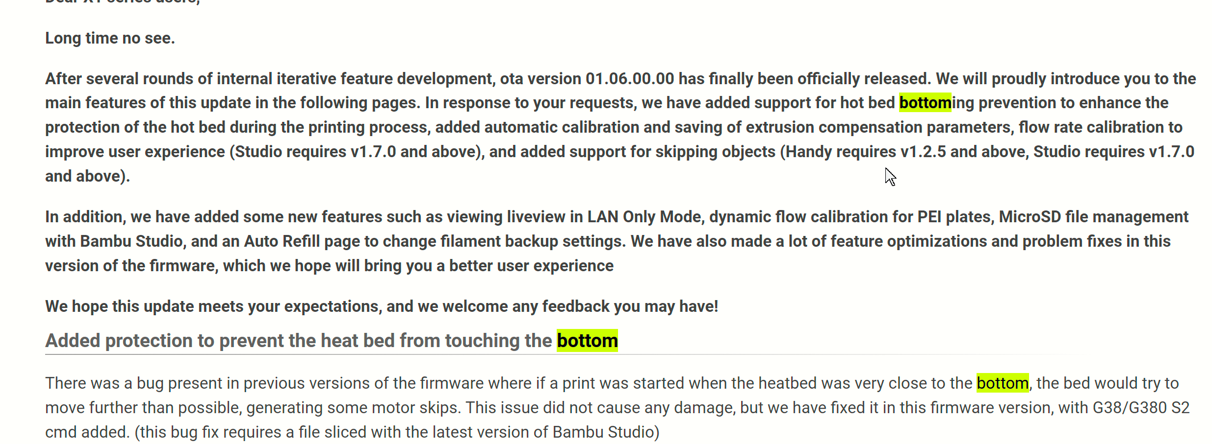

One person did report that they got a message from Bambu and that they assured them it was normal. In a later release Bambu added a feature into the firmware that would minimize the grinding sound when the plate hit the bottom, not eliminate but minimize.
Curious are you on the latest firmware? Mine use to do that but it was fixed a while ago.
Thank you. They don’t really need a physical switch; they could use the same type of sensing as when plate is homing home - sensing resistance. This still doesn’t explain the “overshooting”…
@silver118822
No, I’m on 01.08.05.00 (20250312). This was supposedly fixed in 01.06.00.00 (20230801), but I’m still getting this issue. The gcode does use G380 commands that supposed to fix this. Unfortunately, the way bambu is heading, I’m not planning on upgrading to annoying new firmware where everything now is hidden behind menus.
