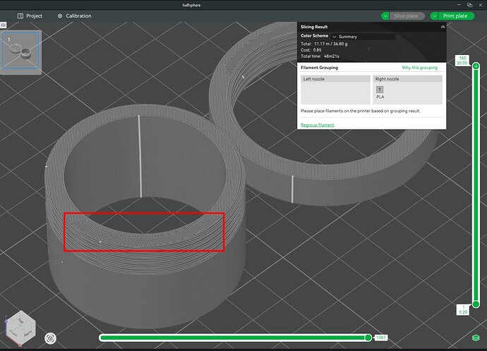

Why did it change the direction/angle of the print in this area?
Without more information, this is a guess.
As it is at the top of a screw thread and been at the point the thread ended, it may have had little material underneath to support it, thus it caused a new direction.
Use the layer slider to go down each layer in turn to see how it was built up.
