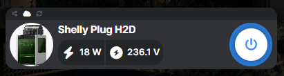

20W (220V) is really high! At some point, when the printer has shut down further, it still consumes about 15W (220V).
The A, P, and X series consume about 5-6W (220V) in standby. That’s OK.
My electricity in Germany is expensive (0.35€/KW).
I already have so many devices in standby mode.
I’m really sensitive to that.
What do you think?

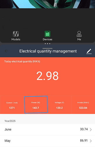

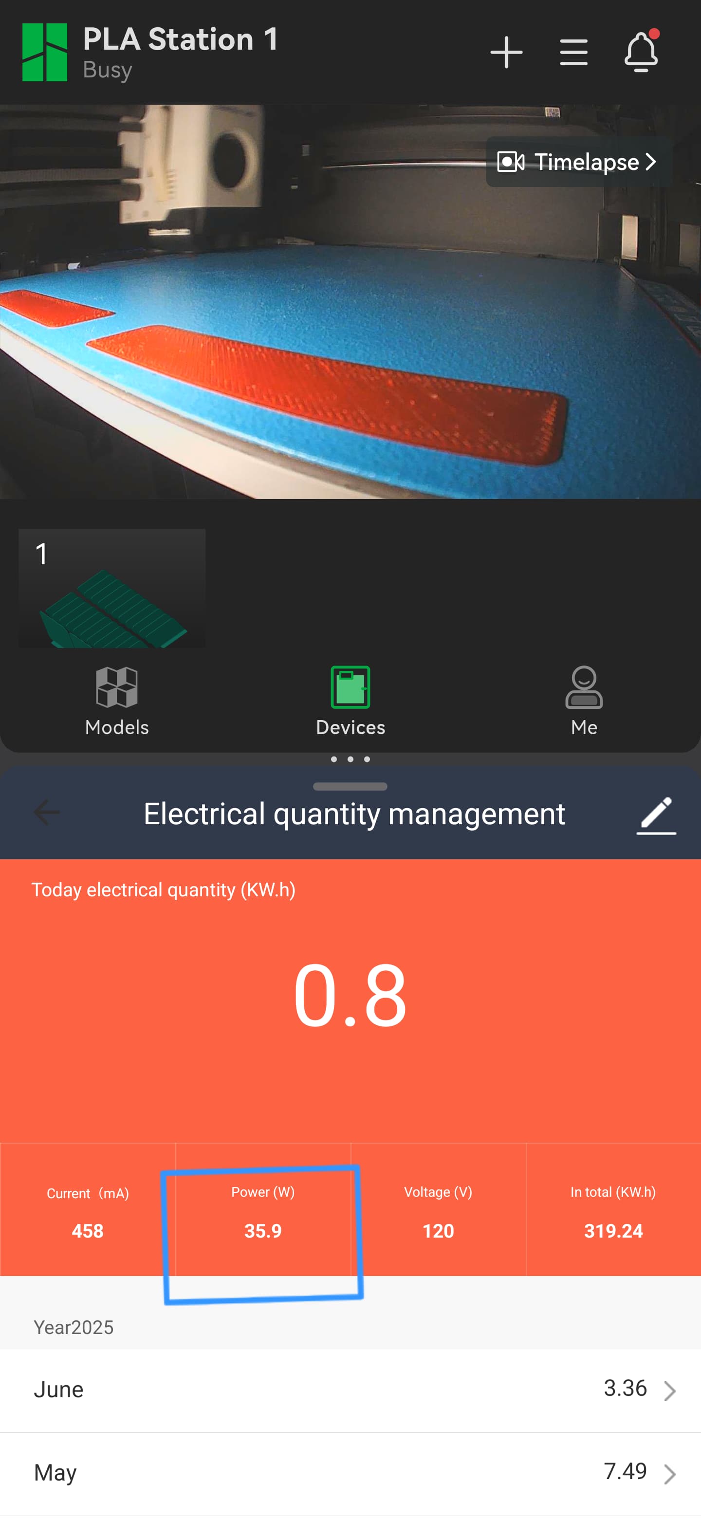

I used my smart plugs to measure the instantaneous power of my devices
P1S running PLA @35C bed steady state, light off (saves 2~3W)
H2D running PLA @45C bed steady state, light off (saves 8-10W)

I already have all my printers connected to smart plugs.
So I know how much power the printers consume in standby mode.
I wonder what consumes so much power in standby mode.

Shelly Plug S Gen3.
https://www.shelly.com/de/products/shelly-plug-s-gen3
